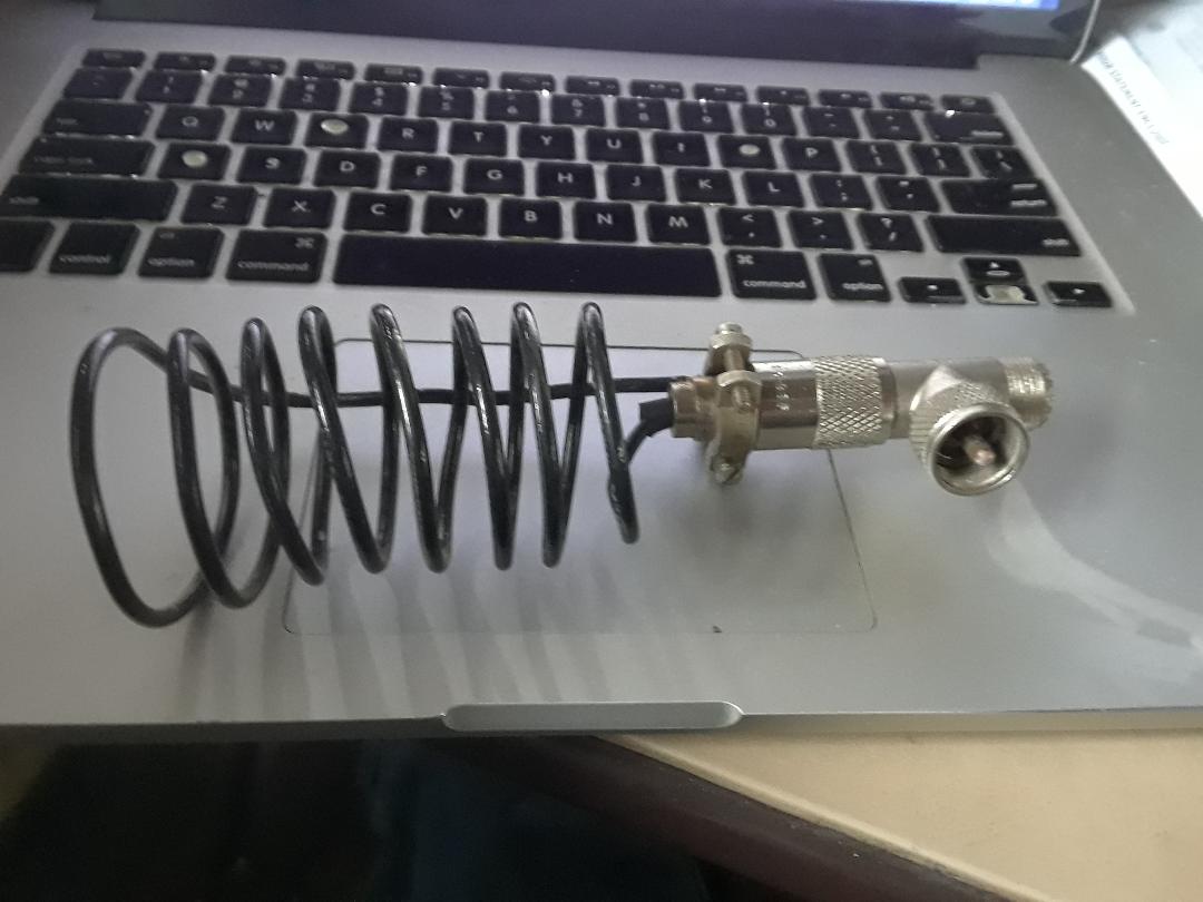

I mainly operate on 75M, and sometimes on 40M when traveling long distances. I haven't needed to install an external shunt coil with the Little Tarheels, but did need to experiment with multiple iterations of them when installing HiQ antennas on other people's vehicles.
Here's one I still had hanging in the garage ...

Not a clear pic of the shunt coil to see what you used. It needs to be enameled wire with the ends having the enameled scraped off so it can be attached to a ring terminal and ground.
The Little Tarheel is not likely to benefit from a shunt coil because the antennas has the matching from within and that's why that antenna doesn't come with one.
The Little Tarheel HP has far less and thicker coil inside the antenna and has a feedpoint impedance of less than 20 ohms on 40 meters and a bit higher on other bands. This lower feedpoint impedance needs the shunt coil to bring it up to 50 ohms.
Tarheel sells the shunt coils. I had a Little Tarheel on my Jeep for a few months, many years ago. I sold it because it just didn't meet my expectations for what I was trying to accomplish...meaning it was basically a dummy load except under the best propagation conditions. You said that it "shuts truck down". What do you mean by that?
