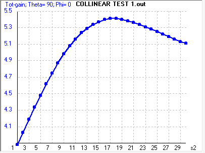

I just loaded 4nec2 on by backup installation (something I always keep but sometimes forget I have). It turns out I remembered wrong.
I started with two 1/2 wavelength center fed dipoles in a collinear setup, and I moved them apart 1 foot at a time. Peak gain happened between 17 and 18 feet between them. Factoring in where the current nodes are, that is very close to 1 wavelength current node to current node.
You said you have the dimensions of the antenna? I have some of them from the manual but not all of them, especially that coil, I know it has 9 turns but know nothing else... Also, what frequency is it tuned for with said dimensions?
Here is a chart of the data, the numbers across the bottom are the distance between the two elements in feet, the numbers on the left are gain.

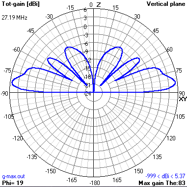

This is an initial look at the 5/8 over 3/8 groundplane collinear concept. My model is not based on the dimensions of the G-Max, although it will be compared to them with my thoughts given as well.
The model I made has a feedpoint impedance of 68.9 - j0.24, which is an SWR of 1.38 and very close to resonance, not bad for an initial look at a design concept...
Also my model is modeled at 1 wavelength above the earth, matching the models from the site. With certain similarities between said models I believe them on this, so I don't think they mounted the antenna super high to overhype said gain.
For reference, this is the data taken directly from the Grazioli antenna site. It is all one image, so I am posting it as is. We will be comparing the middle and right sections of this image.
My current and phase looks similar to the G-Max.
As their current distribution comes very close to my 5/8 over 3/8 design, I wonder where they came up with the 5/8 over 1/4 idea? Using a loading coil, such an idea is possible, but I just don't see why they would say that for this antenna...
Now for the gain...
I get far less gain, and the patterns are different. I'm not 100% sure why yet, and I don't have time to play anymore, have to get ready for work... From what I can tell, the angles of radiation are 1 degree off of each other, so in the regard we are in the same boat. I have far less gain than they do. This could be due to a combination of any number of things, different ground, I used aluminum elements and they used perfect conductors, different dimensions, ect.
This structure is already in the range of 75% efficient, which means 25% of the signal is being lost before the radiation happens. I'm pretty sure that if I adjust the lengths of the upper and lower sections I should be able to pick up more gain, and change the model so that it more closely matches the one they provide, but I doubt there is 2 dB worth of gain to pick up...
When I next get a chance I will have to experiment with using perfect conductors, and with adjusting the dimensions of the antenna.

I took the model from above and made the changes as per your posts. Somehow I completely missed the lengths you had already posted on the first page of this thread...
Anyway, I presumed that if I shorten the upper and lower vertical element lengths that gain will go up, and it did. In addition to shortening said elements to your lengths, I also lengthened the coil from 8 to 9 inches to better match the antenna. One day I may or may not actually put the wires in to model said coil directly, but that is a decision for future me...
These changes netted a gain of nearly 1 dB, which was more than I was expecting, but its there. I should note that the original model under reported gain slightly, and this one over reports gain slightly, so there is that to consider, but even with that I am surprised at this change in results... Anyway, here is the model...
This model has a feed point impedance of 52.5 + j 1, which has an SWR of 1.05, so it matches very well. The structure also has a much higher efficiency than the model above, which is where I think most of this gain over that model comes from. It is still 1.1 dB off of the provided G-Max model...
I mentioned that I was using aluminum elements, and not perfect conductors, so to see the difference, removing the "lossy" aluminum elements in favor of "perfect conductors", nets me a whole 0.01 additional dB bringing it up to 5.38 dBi in gain so that isn't the cause of this difference...
Beyond this, I am wondering what is different between their and my models? Like me they seem to be using a lumped inductance, but unlike mine, theirs seems to be much a smaller section that doesn't account for the length of the coil? This can have an effect, but 1.1 dB worth? I highly doubt it.
I guess I can play around with earth settings and see what happens... I'm not sure what else I can to do duplicate their data short of seeing their model data itself and figuring out what else is different?

CEBIK got a little more gain changing to a physical coil, he thought part of that was the increased spacing,
Grazioli make 2 claims for gain,
In the Electrical data it says 5.65 dbi ( no frequency specified )
very close to your model a fiddle with the ground could find the difference or a physical coil maybe,
The model says total gain 6.48dbi @27.5mhz & 11mtrs above real ground,
can ground type do that ?
