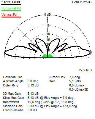

The above models were over Average "Real Ground", this one is over Moderate "Real Ground". Simply changing the quality of the earth makes this much of a difference...
It is 1.3 db of a difference... Lol, a higher amount of gain than what was in the manufacturers model... This is likely the difference...
It is understandable that they used Moderate ground over the Average Ground that I used. I'm actually the anomaly here, not them, as Moderate Ground is the default option in 4nec2. The reason I used Average Ground is more or less Eddie (Marconi) may he rest in peace, and him claiming anyone who used anything other than the Average Ground he used was trying to manipulate the data, in spite of the fact that Average Ground was shown to be anything but average... Long story, no need to revisit now...
Anyway, my model got a higher gain, does that mean I win? ;)
With this information, I would call their model legit.

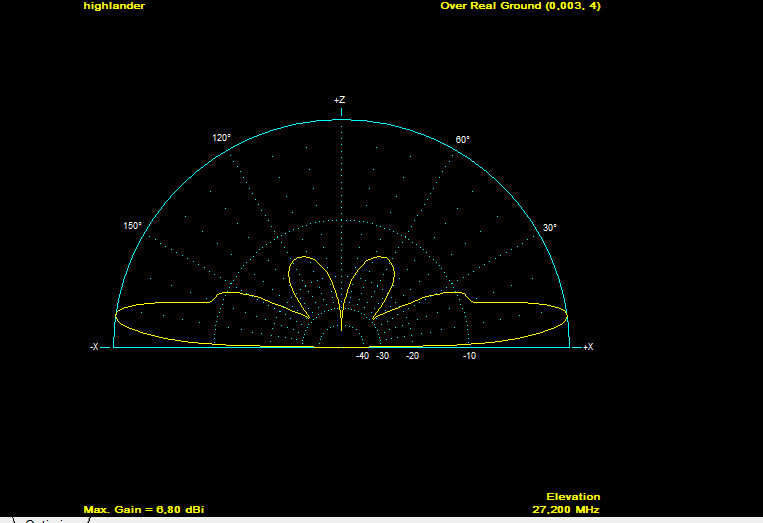

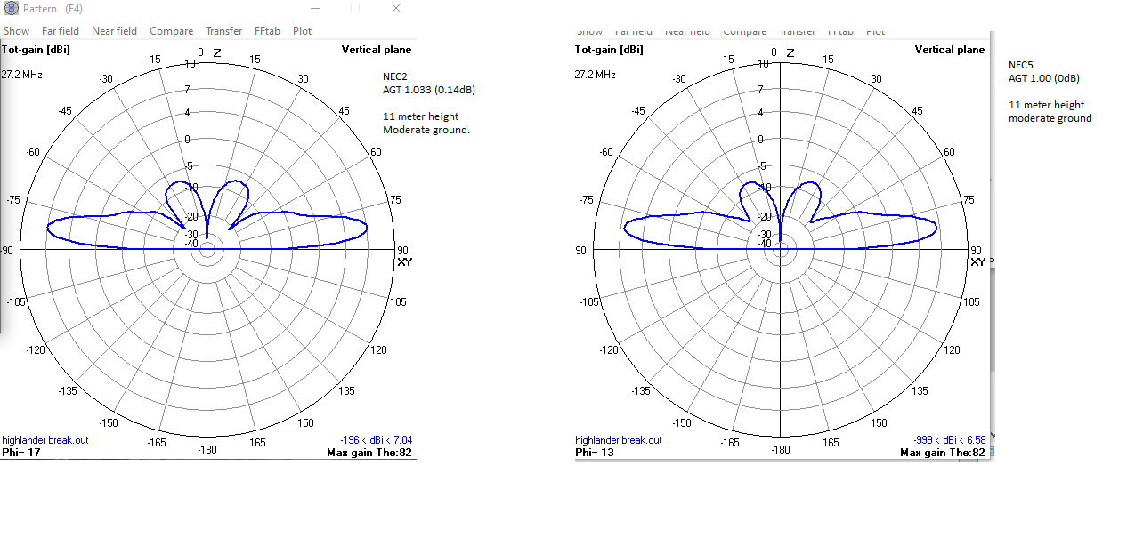

Above an example of NEC2 versus NEC5 with the collinear I made in the past.
NEC2 shows 7.04 dBi in gain where NEC5 indicates 6.58. (Using that moderate ground conditions). This while the AGT tells us: it should be down with only 0.14dB. PS i didnt optimize for lowest NEC2 AGT....this is just to get an idea.
Just for fun... :)

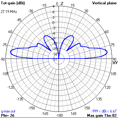

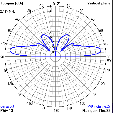

Here is a MININEC example using "Antenna Model" by teri software,
Kind regards,
Henry

You CAN use NEC5 within 4NEC2 that is no problem.
You can use NEC5 with 4nec2? When the author gave his final update he specifically said he was not going to include NEC5 support, and I haven't looked into it since then, so this is news to me. As I look around the web for this, some people are saying that it appears to work, but the data is off. I would have to confirm with other software, like EZnecPro, which is supposed to work with NEC5 before confirming this as working.
I've run Mmana-Gal before which is mininec based. That program didn't have an AGT, I'm guessing it didn't need it. Further, NEC5 handles segments very similar to mininec, which is why I said above that it is much more forgiving when it comes to AGT.
The way I read the models above, the 4nec2 model, AGT 1.033 (0.14), this is over-reporting gain by about 0.14, making the actual gain the model has at 6.9 dBi. If I use any of my correction methods this is generally what I will get. This puts it at 0.32 dB higher then the NEC5 model. While closer I have to admit that this is a significant difference, at least as far as modeling goes (real world you wouldn't notice the difference). When it comes to the mininec model, it is higher than both of them, and while there are places where mininec is superior, we have to remember its design requirements, and the shortcuts Logan and Rockway (I think were their names) had to make to get there. When I use it I tend to use it as a reference more than anything.

For MININEC I either use MMANA-GALpro or Antenna Model, that last one does have an built in average gain calculator.
And it indeed..MMANA-GAL does gives warnings, but not by means of an average gain factor.
You mentioned..The MININEC model isnt higher then both of them... im not sure I understand what u meant.
It displays 6,8 dBi which is closer to NEC5 then NEC2 is. (NEC2 7,04-0,14 = 6.9)
And although I dont really consider this to be a case where MININEC stands out from NEC2, it does show it is closer (to NEC5).

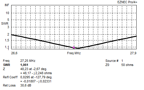

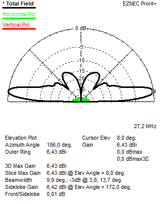

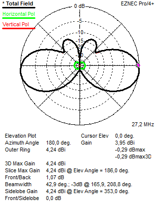

I did an analyse on the G-max:
Which can be found here:
(Click)
Grazioli G-max EZNEC REVIEW
I get 6,43 dBI ( using that moderate ground)
and 4,24dBi FREESPACE GAIN.
Freespace gain.
The manufacturer "moderate ground" ( 0,05 dB off from claim Grazioli).
Above average ground.
And the SWR is pretty much spot on...
