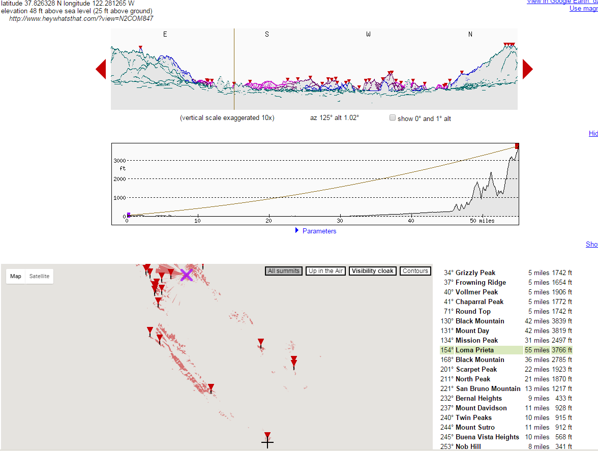

I hit repeaters 30 to 50 miles all the time from ~20 feet above sea level, and that gets me to folks 100 miles out. I hit repeaters 100 miles out when I am parked at 3400 feet above sea level.
Plug your location into this neat little website and see how your line of site works out for your location.
http://www.heywhatsthat.com
Reactions: RatsoW8
For example here's view to my south where I hit a repeater 55 miles away. This then means I can talk to another WWDXer who is about another 35 miles further south.
