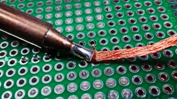

On thru the hole components like caps on older radio's I find just using a simple solder wick and a 40 watt solder iron works good.
Those solder suckers have their place and I occasionally used them too.
