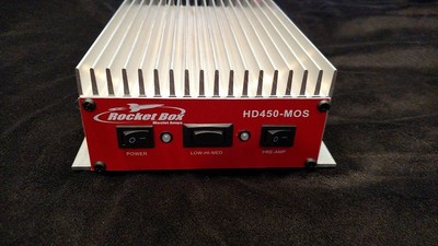

Has anybody tried one of these?
https://www.ebay.com/itm/Rocketbox-HD450-/223219065838
