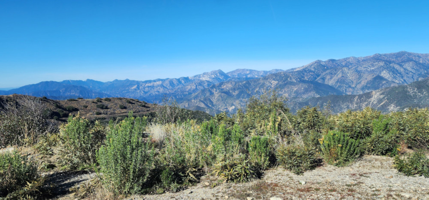

The view up this trail is breathtaking and pictures just don't do it justice. Here's another image looking to the north showing much of the San Gabriel Mountain range.

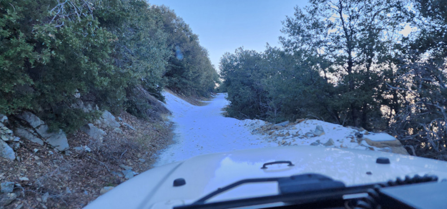

The last few weeks had a few days of light rain in the city and the temperatures in the mountain are low enough to bring a bit of light snow. I was still a little surprised to see snow on parts of this trail, though. The snow wasn't deep, but it was frozen and slick so being a bit cautious was certainly warranted.

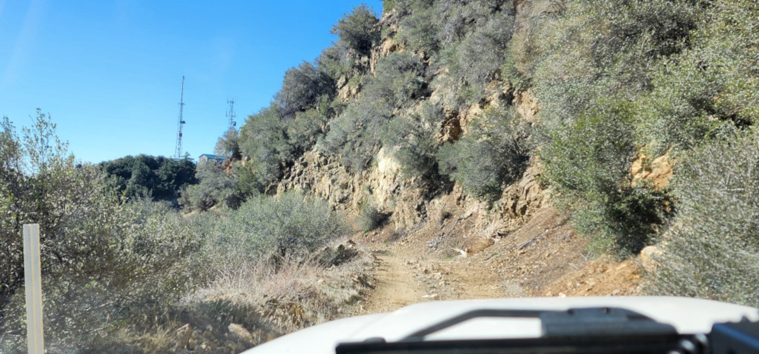

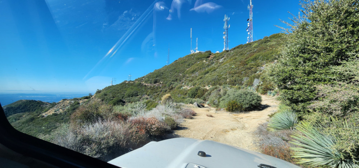

As we go up, the road gets narrower and we start to see the radio towers.
A little farther and more towers appear.

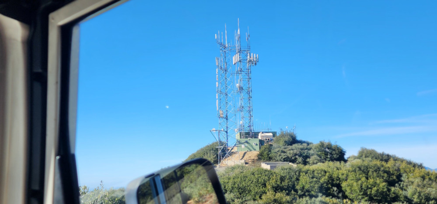

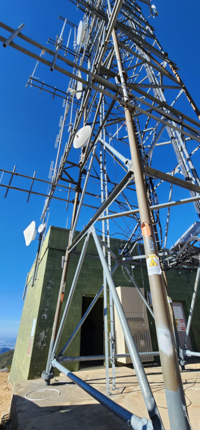

Now a few pictures off the good stuff. This is the vault and tower where our repeater is located.

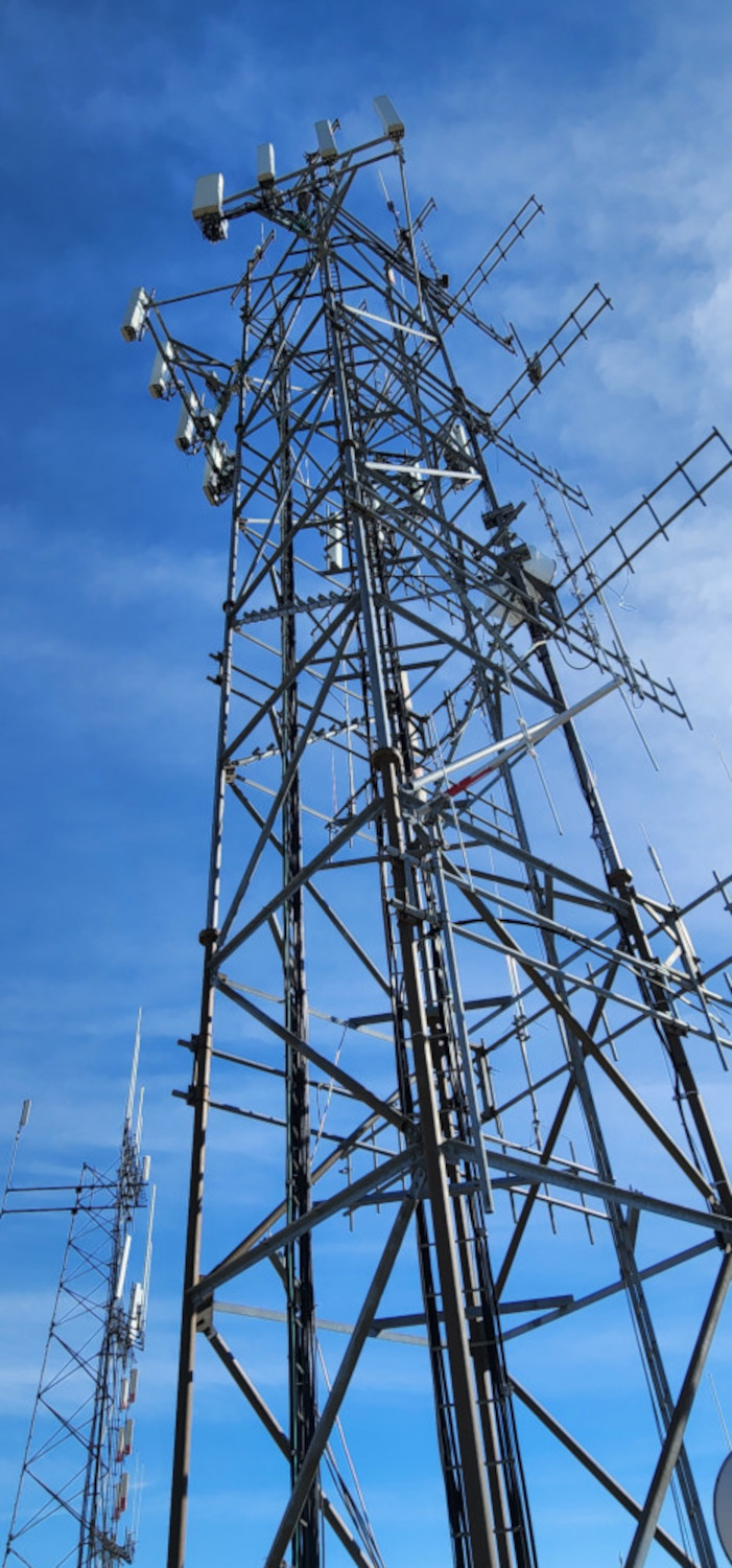

And here's a couple of shots of the tower itself.

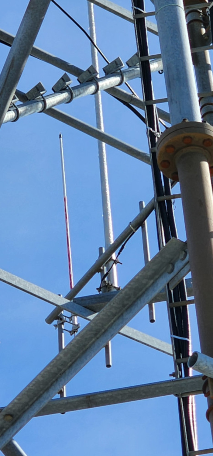

The receive antennas is shared by a couple of different repeaters housed at the same location and is at the very top of the tower, visible here.
Coming around from a different angle, the transmit antenna is about half-way up the tower. In this shot, it's the massive antenna second from the left which extends through the pic.

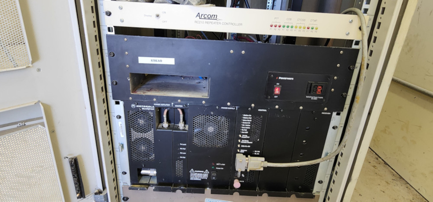

The first task was to replace the failed power amplifier. This repeater is one of the busiest in SoCal and it's not uncommon for it to be busy most hours of the day, every day. This type of duty cycle certainly puts a strain on the PA. Fortunately the effort to do this is just a simple module swap on the bottom left of the Quantar. In this shot, you can also see that we use an Arcom RC210 controller.

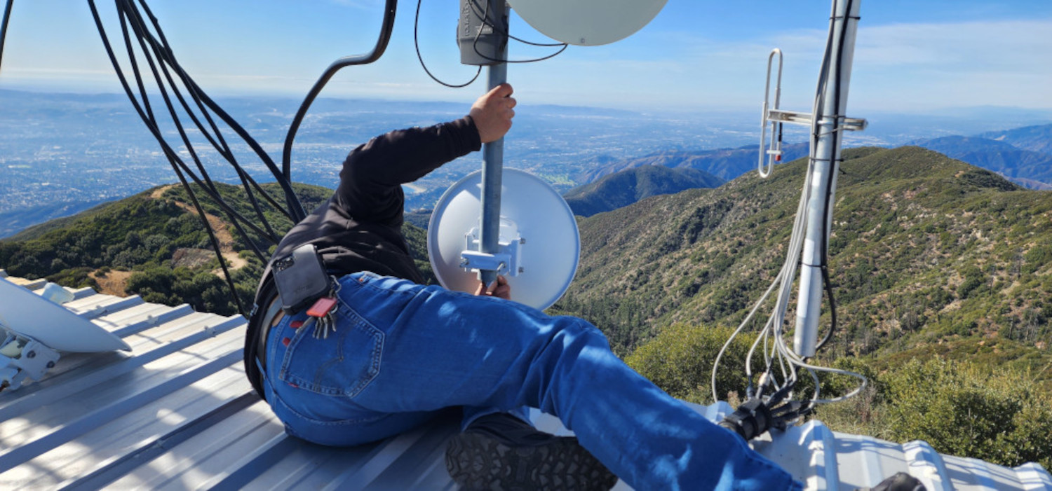

Once that was done, it was time to replace the WiFi dish to reestablish internet service to the repeater. Here's Henry, K9KAO mounting the dish from the roof.

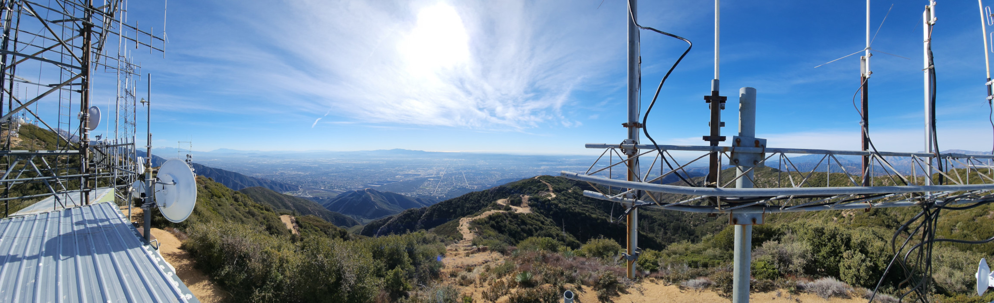

We made bearing and azimuth calculations to the uplink site, so aligning the dishes only took about 15 minutes. All of the existing ethernet and wifi inside the vault was still working, so as soon as the dish work was done, internet was back online. Initially, this just allows us to control the repeater remotely, but we will soon be hooking it up to other services such as Allstar. Before we got off the roof, I took a 180 degree panoramic shot from the site to help provide an idea of the coverage. The Pacific Ocean is on the horizon.

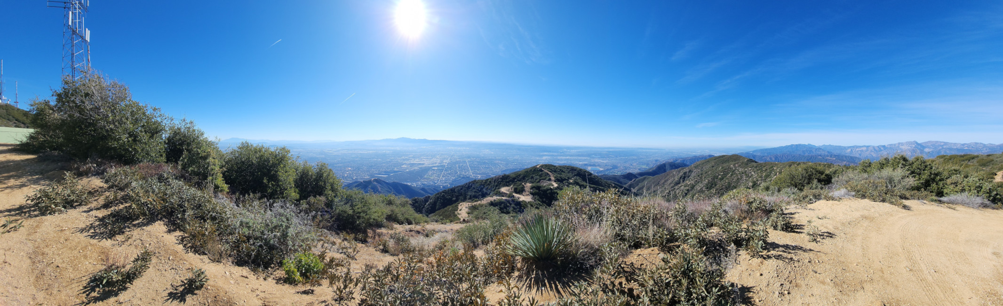

After lunch and a couple of cold beers, it was time to head back. Here's one more shot of the repeater coverage view from the road with the building to the left.
