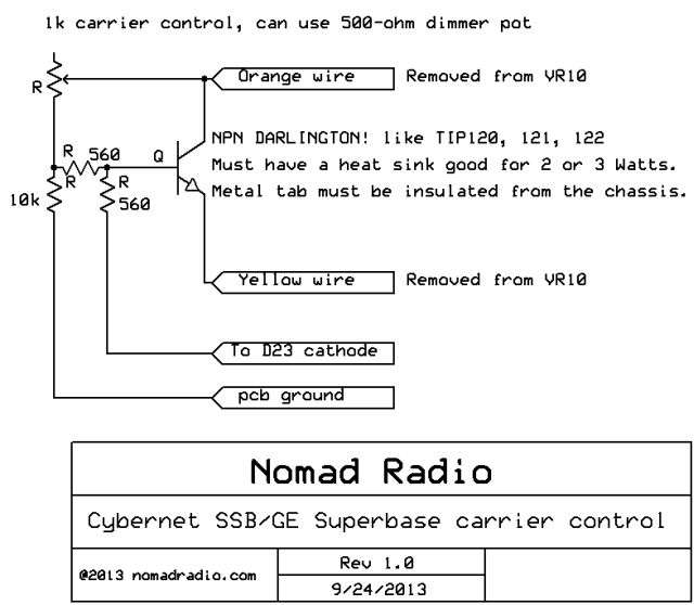

It requires a NPN Darlington transistor and some resistors to take the place of the 10-Watt rheostat. Pretty sure the best resistance value for the carrier control is 1k, though a 500-ohm works. A higher resistance will crowd the control's response at one end of the knob's rotation.
Found a diagram on my ImageShack. Yay!
So, "Yellow wire" or orange for the Superbase may be another color in this radio. The diagram says nothing about this.
If you key the radio on AM, the DC voltage on the two lugs of the fat white rheostat will show different readings. The wire with the higher voltage takes the place of "orange" on the schemo. Comes loose from the old control. Goes to the Darlington collector and to the wiper of the carrier-control pot. The one marked "Yellow" or whatever color is on the rheostat's other lug will go the transistor's emitter.
And where it says "D23", that same functional diode in your radio is D43.
You'll need a surprisingly-large aluminum heat sink for the carrier-control transistor. Bolting it to the steel chassis deck alone won't quite do.
That's the gist of it for these old Cybernet-made radios.
