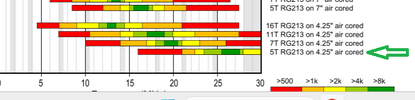

The balun/choke will isolate the coax feedline from the antenna. With it, there is no need to have an exact length of coax to your antenna when you use an analyzer or SWR meter. As Crawdad said, the balun will remove any effects the cable might have on your antenna pattern (side lobes). They are easy to make also!
From Crawdad's link, **5 Turns of RG-213 4.25" diameter** would be the best for you application. (You'll need RG-213 for your high-power application)
