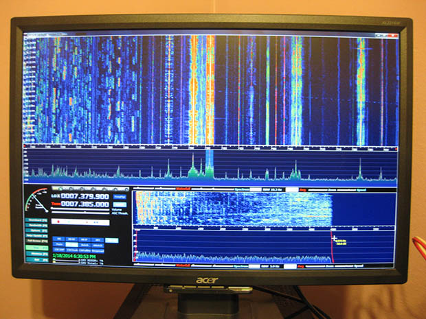

Just added a RTL2832U dongle to the FT-950

and I now have as good and possibly better SDR setup than adding the IF-2000 board and LP-PAN IF Pan Adapter and it is darn sure a great deal cheaper. Total time to install and have it operational is about 20 minutes with the longest time being the removal of all the screws from the bottom of the radio. Now for the price difference, if you go the route of the IF-2000 and the LP-Pan you will spend about $450.00. Whereas if you go the route of the dongle it will cost you about $52.00 which in my book is a huge saving. You can judge for yourself, what you are looking at is 40 meters and I tuned up into the Broadcast band which this time of the evening I spend a great deal of time up there looking for the rare radio stations.

Thank you very much for posting this. I was planning on using the IF-2000 hardware and panadapter in the future, but after seeing your post and checking out the installation instructions for the dongle here I'll be glad to save a lot of money going forward.:thumbup1:
