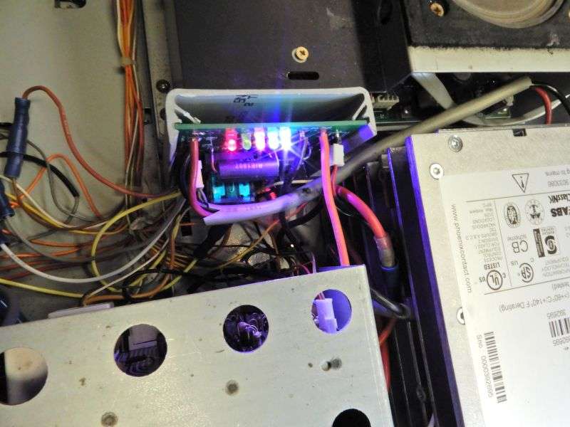

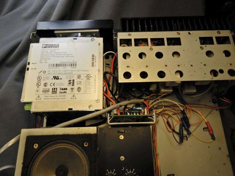

Fast-forward a few years. No I didn't s**t-can the radio in the meantime. A guy with the callsign K6IOK has a company called Compudigital. They sell a switchmode power supply that fits (barely) in place of the original 60-Hz power transformer, and a circuit board with swithmode regulators to step down the radio's internal regulated voltages.

One thing that made the $260 for the upgrade kit seem worthwhile was the upgraded PIEXX cpu board this radio already had installed in it. This board provides a RS-232 data interface and improvements to the radio's memory features and tuning rate. Also needs no battery for memory backup. Every product I have seen from PIEXX has been everything they claim.

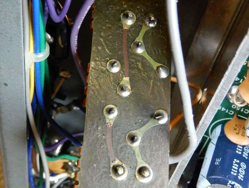

The owner-attempted repair had tripped what I call the TS-930's "auxiliary fuse". This is the solder side of a small pc board at the rear of the radio. Has a power relay mounted on the other side that handles the actual power switching to the original power transformer. The push button on the front of the radio only serves to power-on this relay.

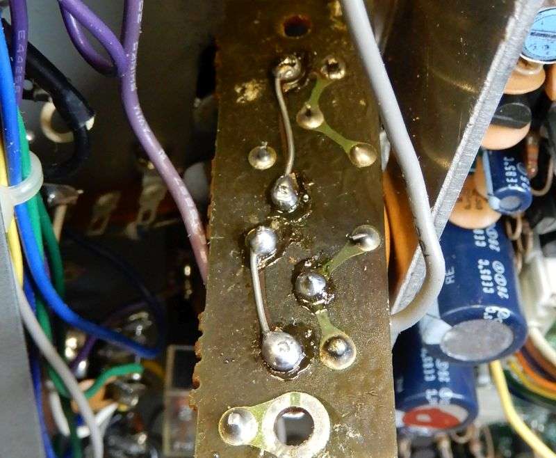

The fix for this fault is simple enough.
Fortunately the relay is stout enough to shrug off the stress from having to vaporize the two foil traces.

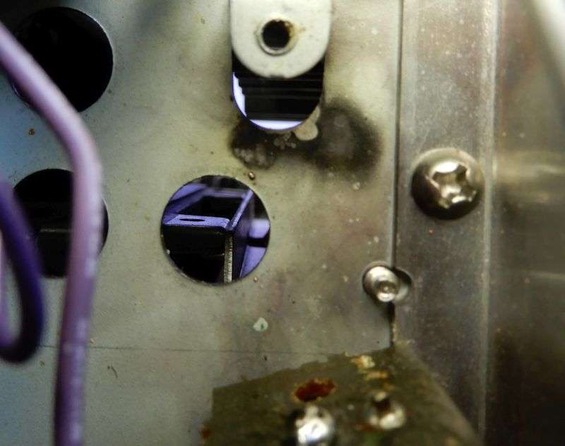

Does leave a visible scorch mark on the chassis where this board is mounted.
But you won't spot this "hint" until you unbolt the relay circuit board.

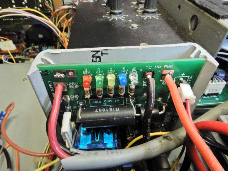

This pc board comes with the kit and contains the step-down regulators and power sockets to run both fans continuosly.
The hookup is not so tricky, but there are two basic versions of the TS-930S. The hookup is slightly different for each.
There are links to some other web pages for the TS-930S at the K6IOK web site that helped to sort out the early radio (this one) from the later version.
The row of LEDs at the top edge of the regulator board shows the status of each input and output. Didn't have to use this feature for troubleshooting, but it still looks cool.

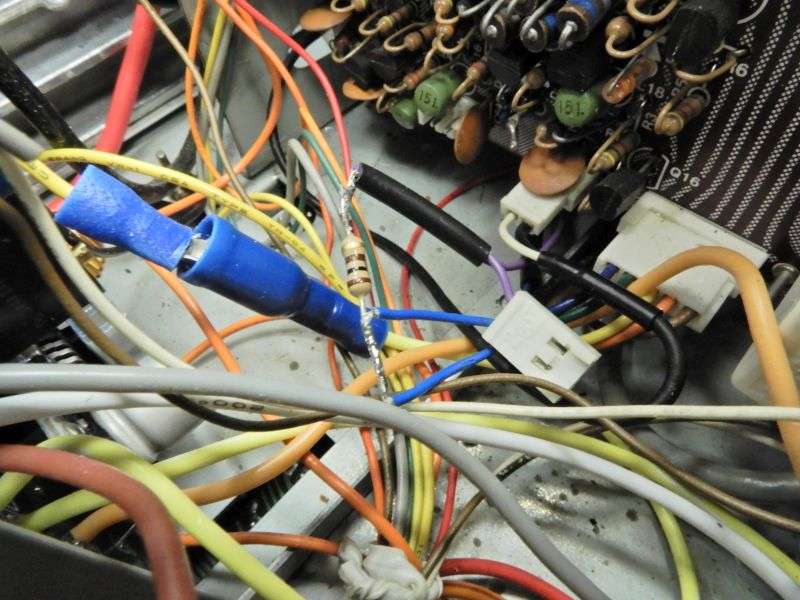

I chose not to run the power-amplifier fan full time. The thermal controller was in fact not working when I did a "hammer test" with a 100-Watt carrier. I decided a better compromise was to run the fan only while the transmitter is keyed. After some cutting and trying, the patch I settled on was a 100-ohm resistor across the two wires on the plug that leads from the low-pass filter board to the power-amplifier board where the temp-sensing thermistor is. Not a terribly neat hookup, since it wasn't the first thing I tried. Does the job.
