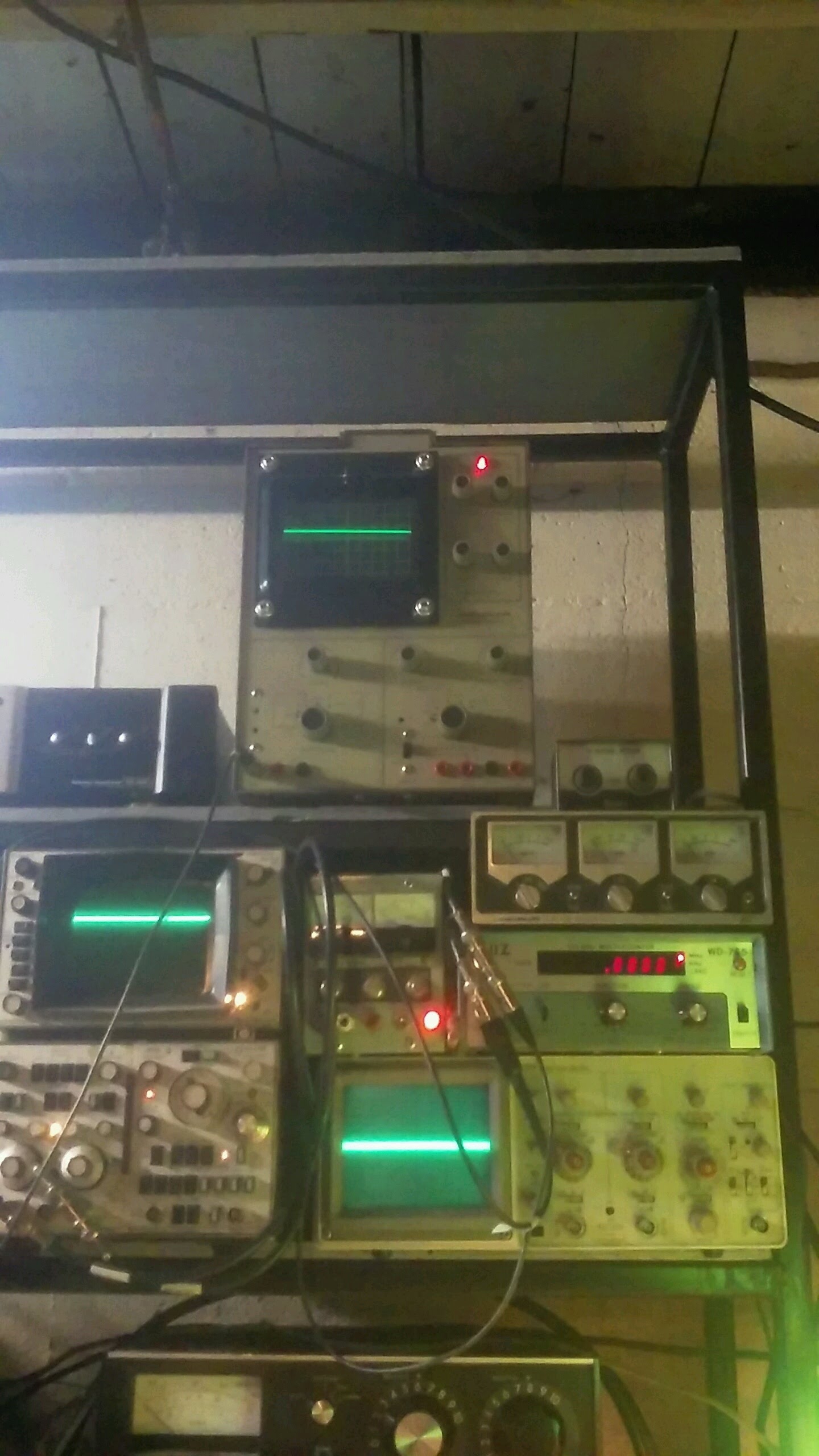

    okay back to work
    Shadetree Mechanic likes this.

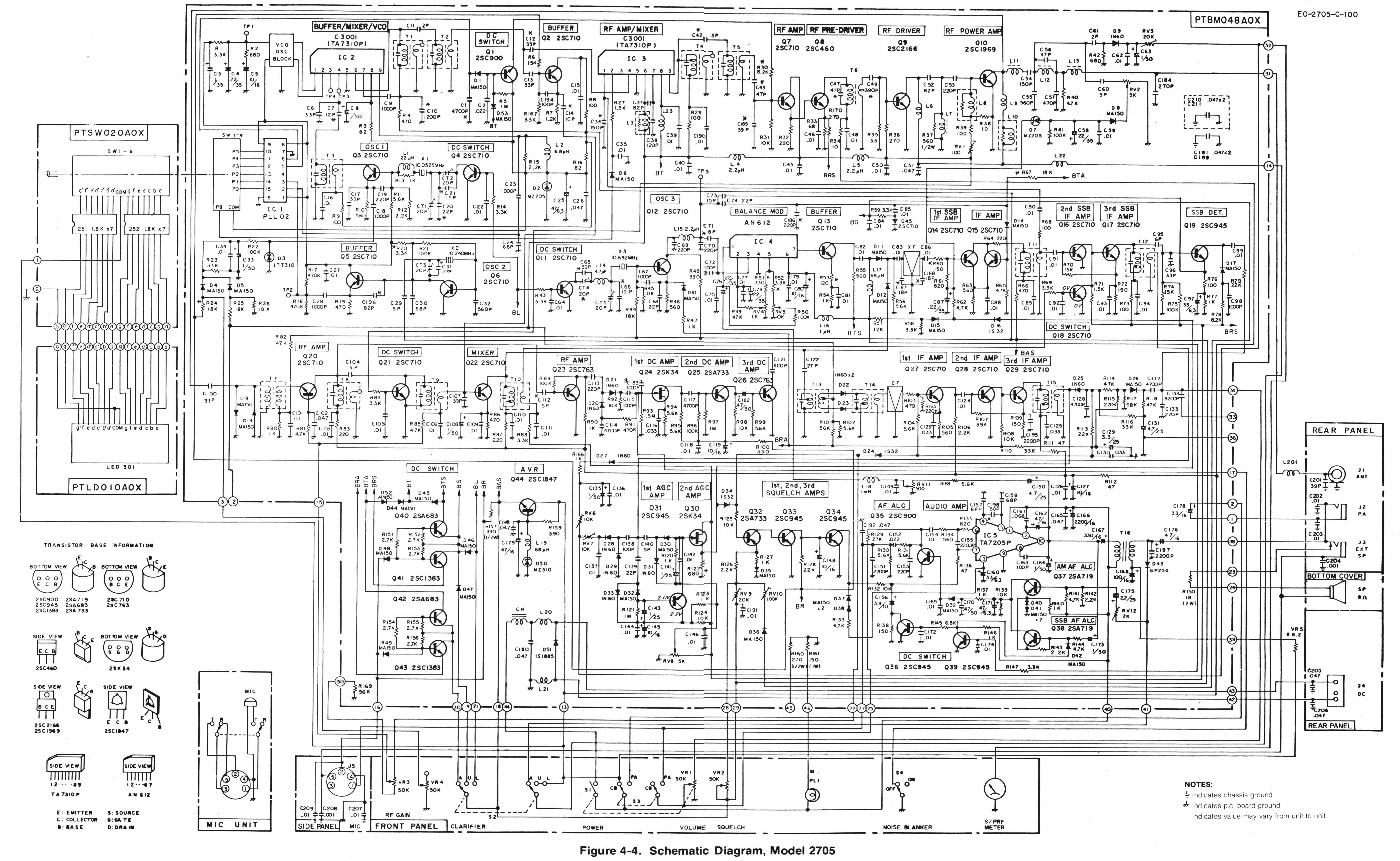

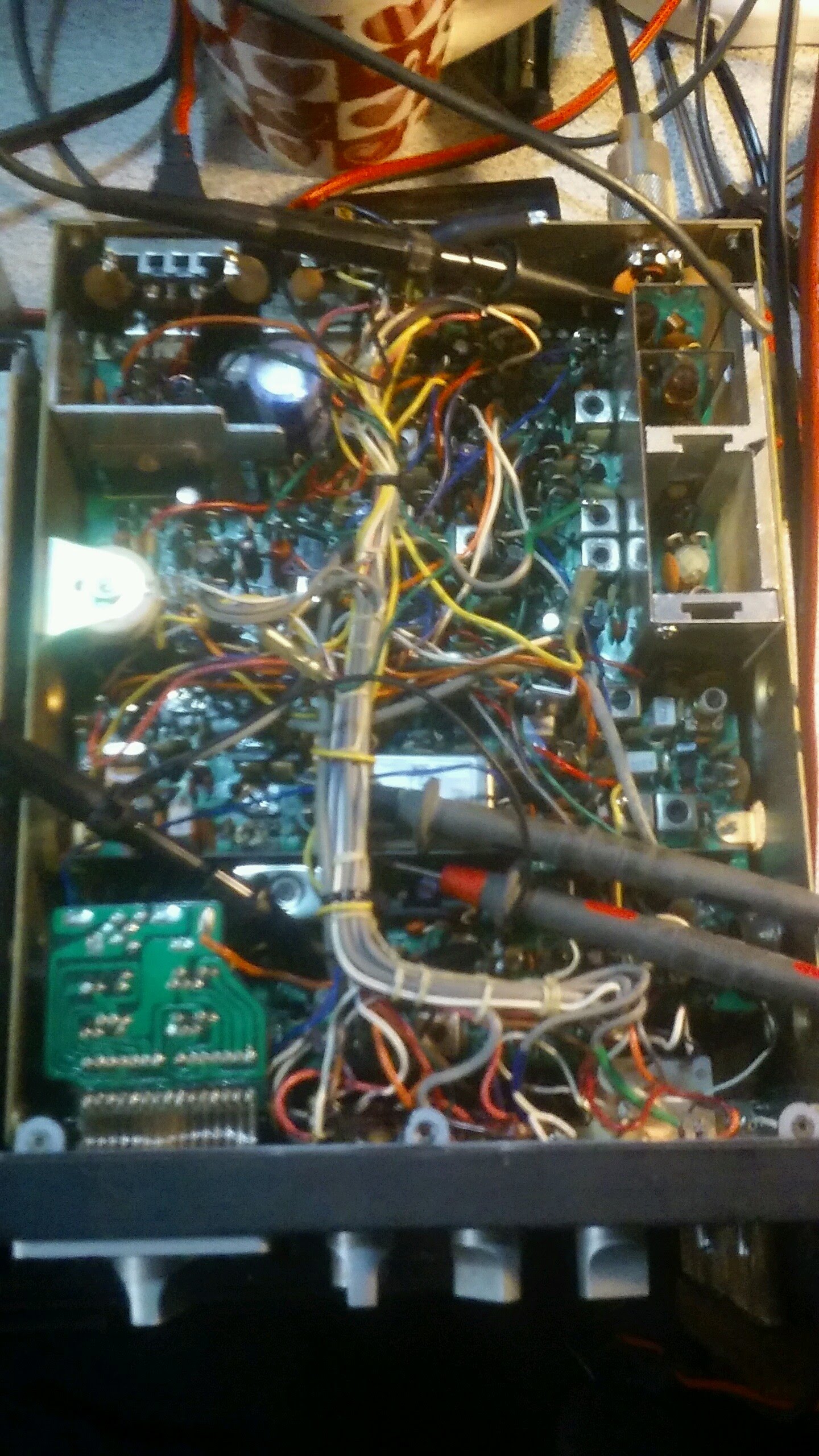

    hygain_5_2705_main_sch.jpg What the hell am I doing in this archaic krap?
    Hygain "V" 2705 ptbmo48aox
    Diode (D51, usual dumb shit)
    Alignment . Why do people turn everything to the right?
    AM Power, How do you break/fubar/mangle a ceramic potentiometer?
    frequencies. Why is there a 10.242 @ X2? D4 and D5 jumpered?! D53 shorted, D46 and D47 shorted?! Diode @ base of Q43 shorted!?
    Carrier insertion points when @ 10.695 & 10.692 are no where near the same distance from center of the filter and when adjusted so they are are no where near the same distance (db) down the slope. Salt to taste ?!
    Q38 installed backwards
    Microphone wired realistic at the radio
    Meter sticking
    Red window over the LED is held in place with bubble gum .
    Fsck'n monkeys
    I need a beer and it's only 11:20 am.

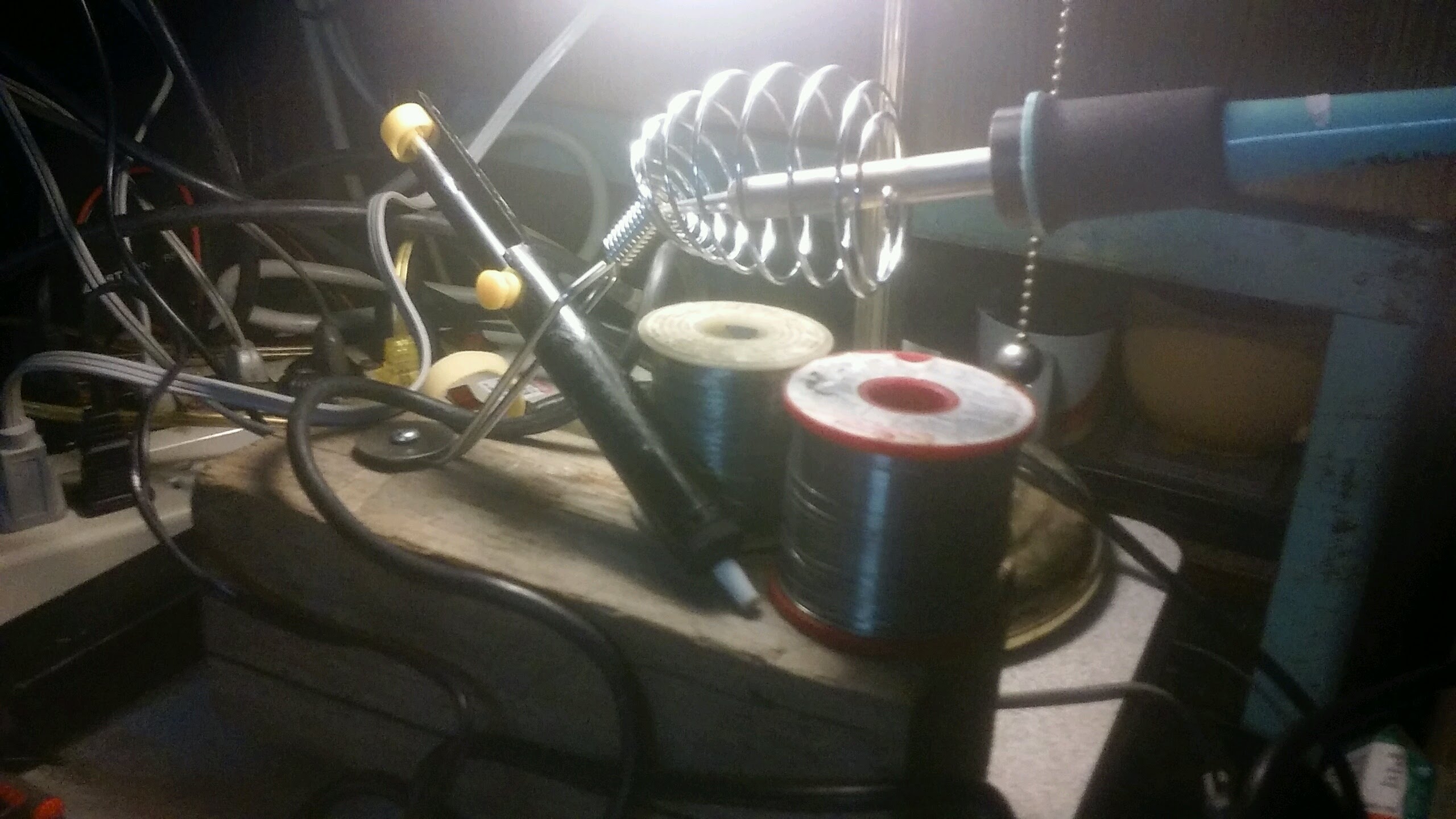

    Thought the Mug would be cute for Mom...
  5. kopcicle
    kopcicle Sr. Member
    Joined:
    Feb 17, 2016
    Messages:
    678
    Likes Received:
    663
    It's her mug. I'm not the only one to use this bench.
    I got it all fixed and waiting for an on the air check .

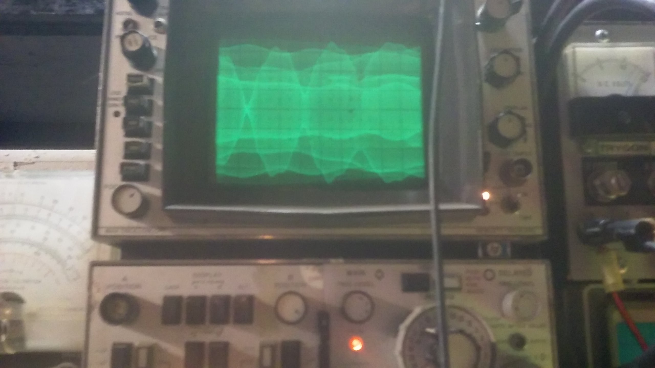

    7ad19e406091ccdd9eae52b741829f014f33e41e-1.jpeg Then when you think you're getting somewhere the 500Hz audio signal goes batshit.
    Oh well , best guess , right ?
