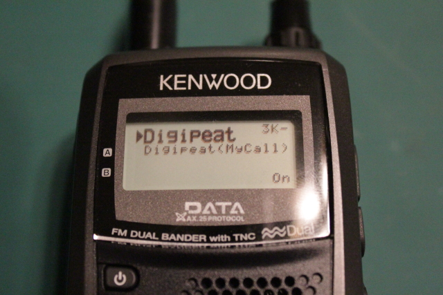

The TH-D72 includes all of the functions needed to act as either a fill-in or full time digipeater. Here are some of the relevant menu functions you configure to enable digipeating:
Enable/disable the inclusion of your callsign in digipeated packets

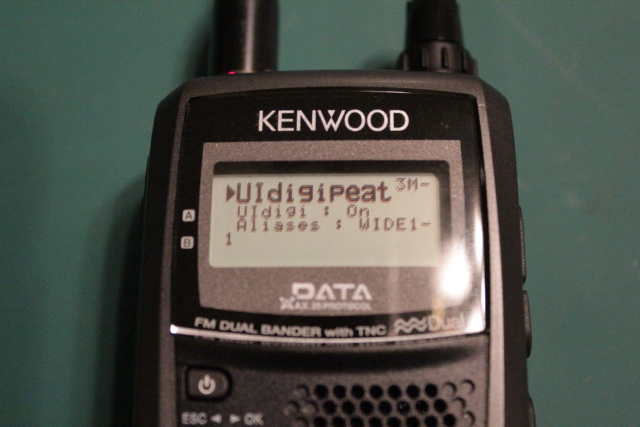

Turn the digipeater on/off and configure the path you want your digipeater to respond to:

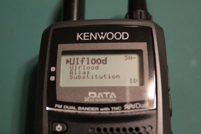

UIFLOOD settings - Typically you will leave this off, but you can use it to enable digipeating for region specific paths (like your state) or even semi-private paths:

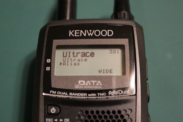

UITRACE settings - When a packet received contains the specified alias, decrement the hop count and add your callsign to the trace:

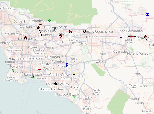

I have successfully tested and used the TH-D72 as a local digipeater and it works well! When used in conjunction with software like APRSISCE, you can configure a 5 watt digipeater/iGate that works to relay other station packets over the air, to the APRSIS network, and also relay messages. There is no other handheld radio available at this time that supports the full compliment of APRS functions like the TH-D72 does.
