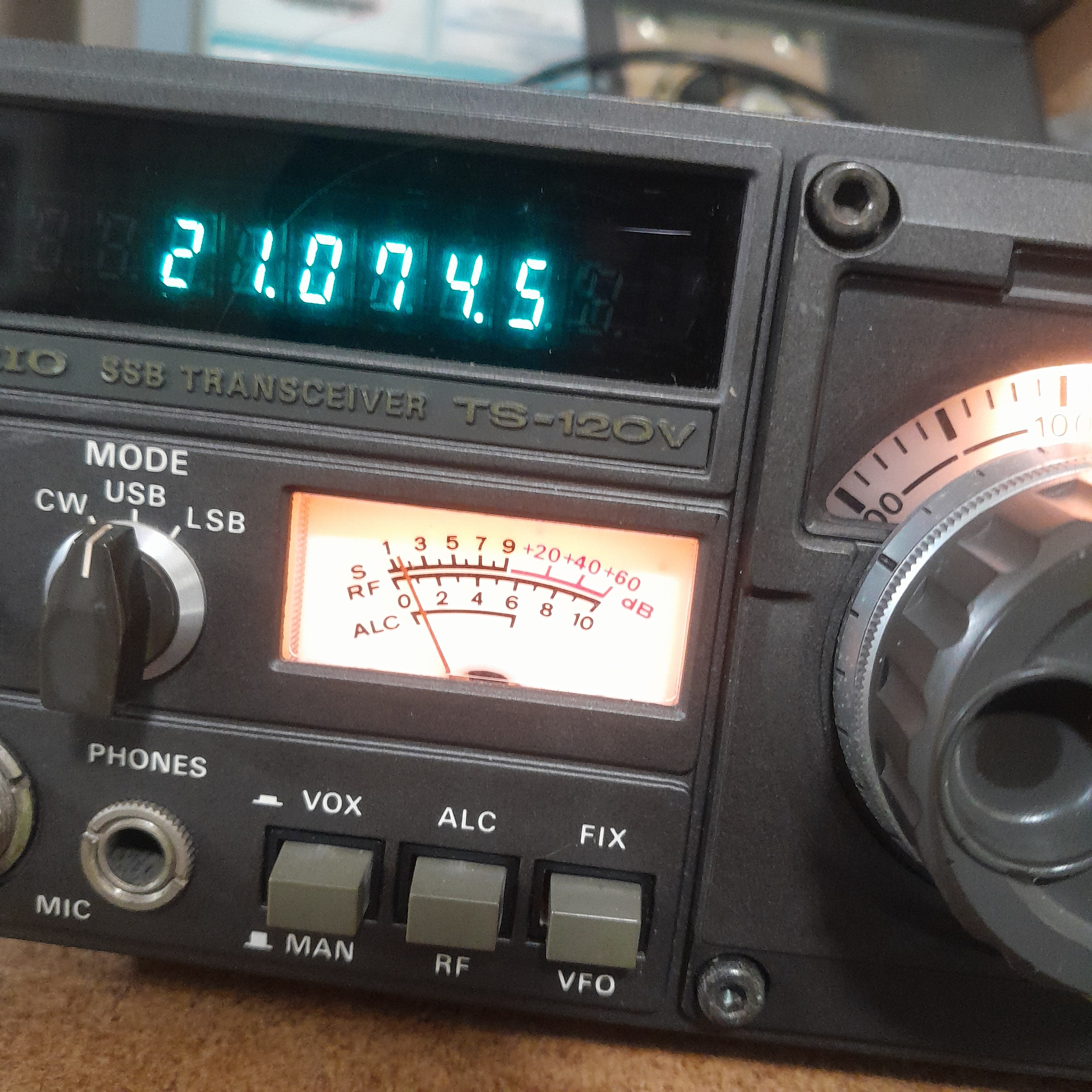

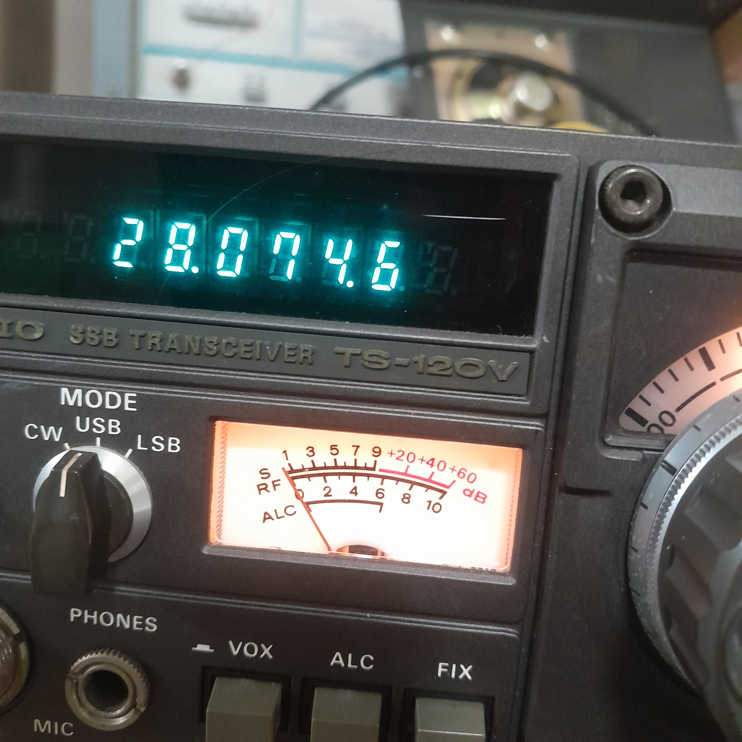

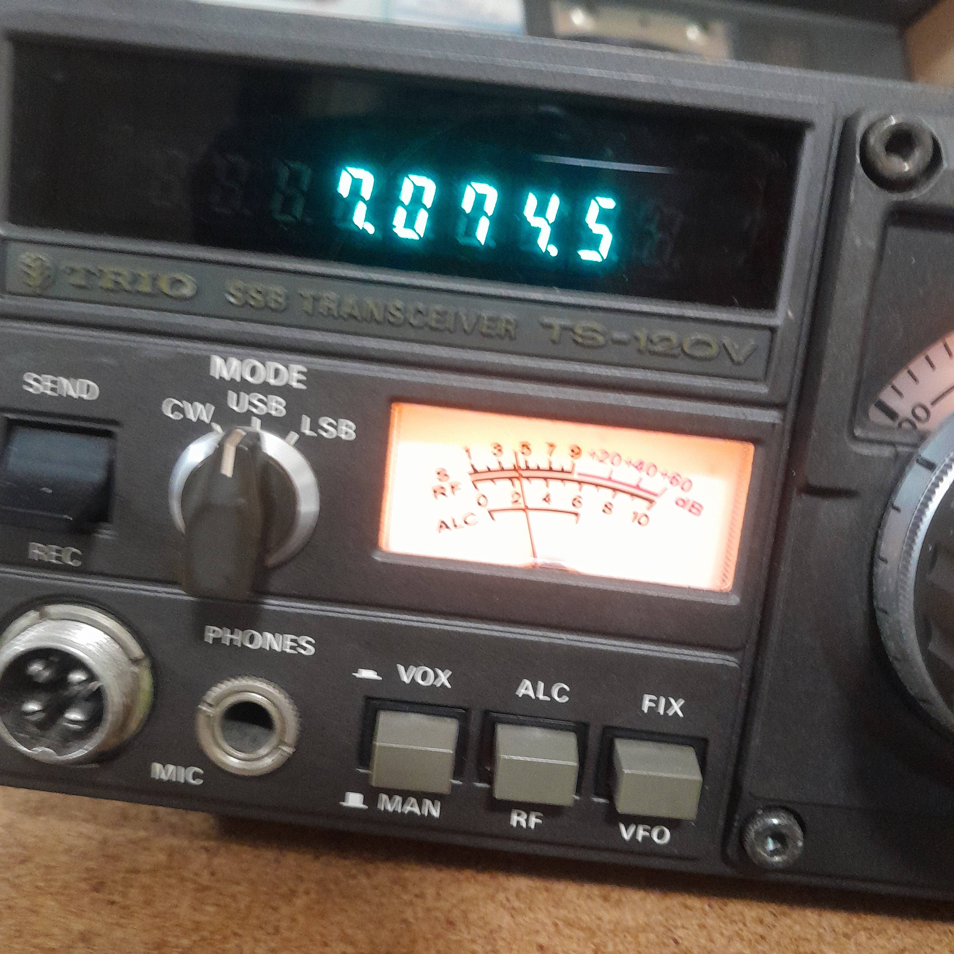

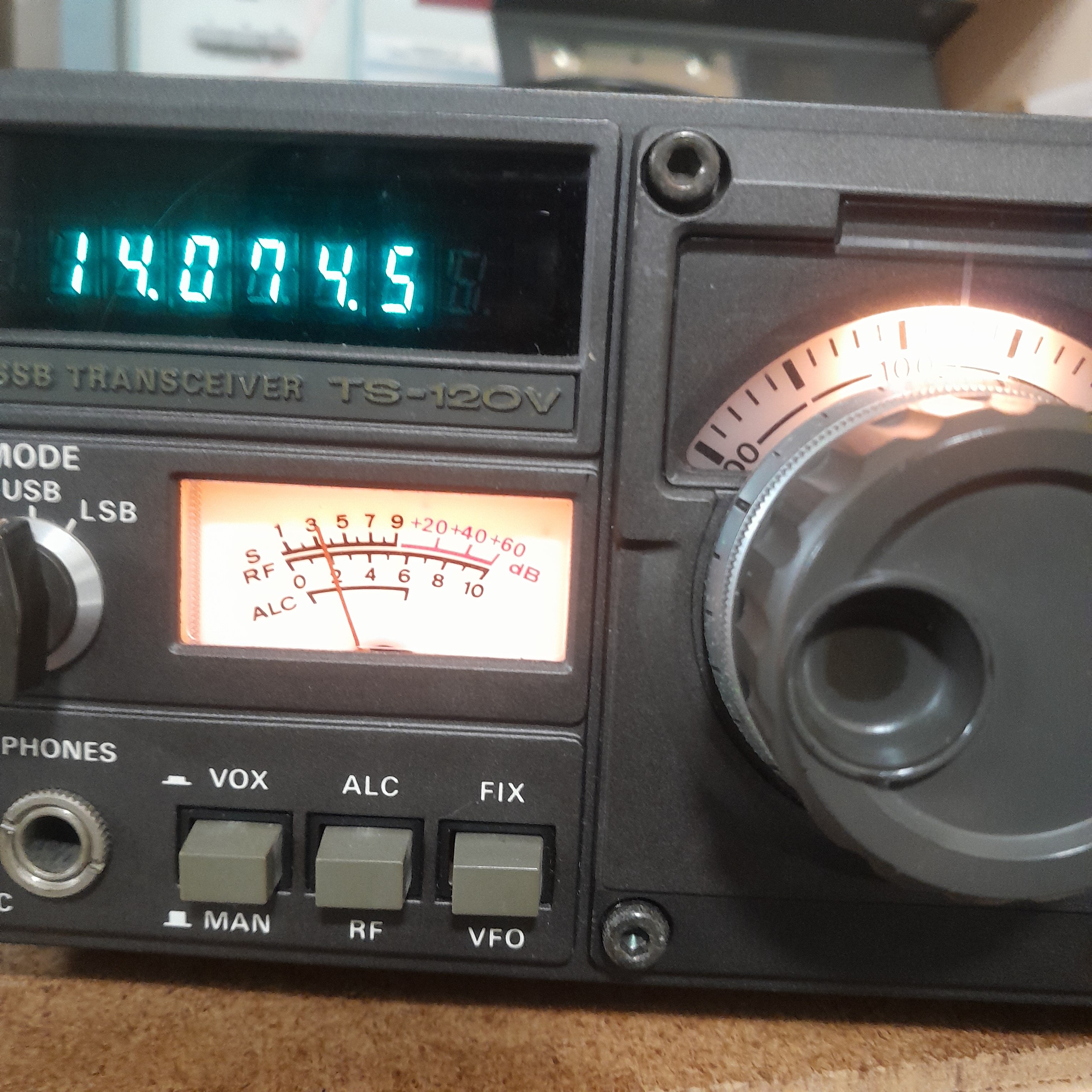

Yes, Thank you for info. Update: I have followed the online service manual the best I can. I found out when looking at the adjustment sections, first I had to convert from Japanese SSG to American SG.
After that I had to convert from either uv's or mv's to dbm. Some of these are listed in the service manual.
I was interested in the section pertaining to the S Meter. Anyway I adjusted VR2 and VR1 on the IF board. They seemed to help with getting the meter to move more.
I did this using my signal generator, setting the output after I did conversion best I could. A 1uv signal or no signal sat
the needle at 0 or 1 S unit.
A - 73 dbm signal put the S unit on 9 db.
A -13 dbm signal raised the S unit to S9 + 60.
My TS 120V will receive a signal all the way down to the min of my generator, -119 dbm on all bands.
So with no ant connected, (only gen.) then S meter is on 0 with 1uv or lower signal
but when I connect a outside ant ( I have a receive only antenna, a 20 to 30 ft. wire
connected to coax pin then thrown up accross small tree, no counterpoise.) I get higher S readings on background noise. 1 db on 15 Meters 3 on 20, 0 on 10,
7 on 40.
Any help on this would be highly appreciated.
Thank you, Jim.
Will yry to attach photos.
