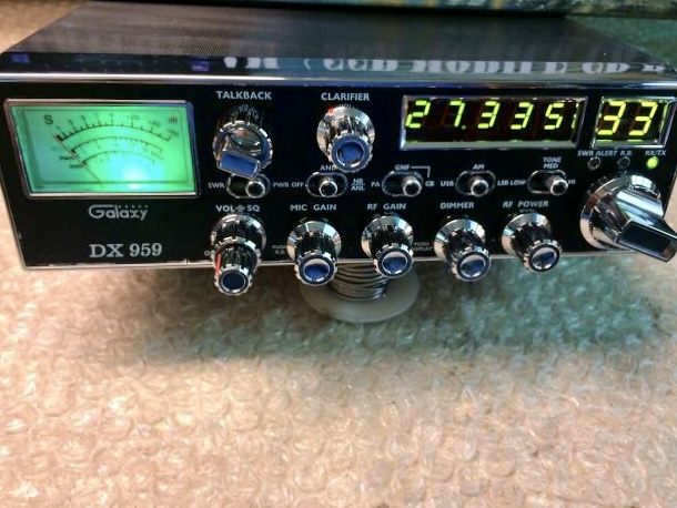

A GALAXY 959 is one talkin’ radio.
Pair it with a 225W RM ITALY KL-7505.

Starting today I’d have the 959 versus the 99V2 (the extra $125 should go towards the DSP Speaker). Best modern radio (post-1990) I’ve chatted with. RX/TX can be among the best in clarity & distance (where antenna install is on par; a friend runs a pair of Wilson 5000 on his 379 that truly gets out. No foot warmer).

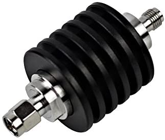

If I had a swing to 15W with 2.5W DK (test bench numbers), turning it down to 1.5W would give (?)
If it’s as simple as 6:1 (don’t know) it’d be hitting 9W with the lower DK. Max Input 10W (per directions). Is it this to which you refer?
Or that an Attenuator ought to be affixed to solve both that and an initial high momentary power spike (if I read that correctly).
If so, point me at a source for same with what spec (thanks).
Or?
