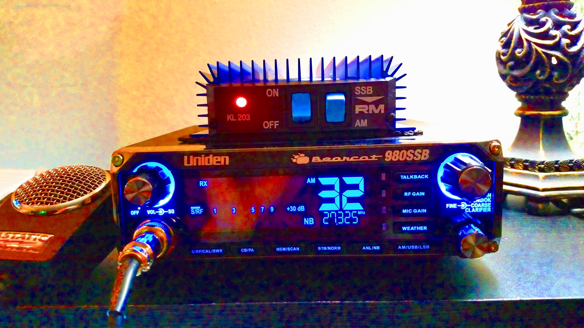

Kl203 amp
I do not know the jumper settings off hand. You can Google the jumper settings. If I remember its either just moving a jumper or de-soldering a resistor. They were build to be converted. Watch the deadkey on your radio. The recommended deadkey is 1 1/2 to 2 watts only. It should sound well. CBradiomagizine did good review on the amp a while back.
Reactions: Slowmover
I think the 203 should be ready to go right out of the box. I have two of them and did not need to change anything. I have heard of people changing jumpers but I'm not sure which RM amp it was.
Years ago I bought one new and it came with directions and a drawing of how to convert it. All you did was unplugged a plastic peg and moved it over one slot. More recently it seems they ship ready to talk.

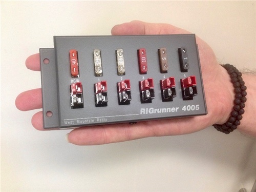

Note: The best way to mod one of these is as I’ve described; so that:
1). A DC power distribution panel can be used (SotaBeam, RigRunner, etc); no splicing into Radio power leads as might be tempting in mobile installs. Both Radio and Amp use APP ends to run from DC panel.
2). And that the Amp (and Radio) power pair is long enough to get a number of wraps on a ferrite toroid or snap-on bead (of appropriate mix).
3). A few patches of industrial Velcro (10 or 20#; whatever’s handy) to affix to Radio case-top. Think “location” more than tight securement.
4). Where, when other COAX in-line devices may be in use (bandpass or cube filters),
the relation of DC panel, radio, plus amp coax & wiring are the ones to have secured to (and from) each other. It’s all as one, now.
5). Radio & Amp are subject to operating adjustment. Getting down the road (or at a base) means the trio is going to get jostled by the operator. (Where the set goes INTO a vehicle space; a slipseater box would be a different, less worrisome “install”).
Get the fixed distance relation problem done first.

C809CE44-D317-4C1C-AFFA-C1CCC36B9D85.jpeg 1513ED9F-B909-473D-9788-81D1B67A4ED4.jpeg

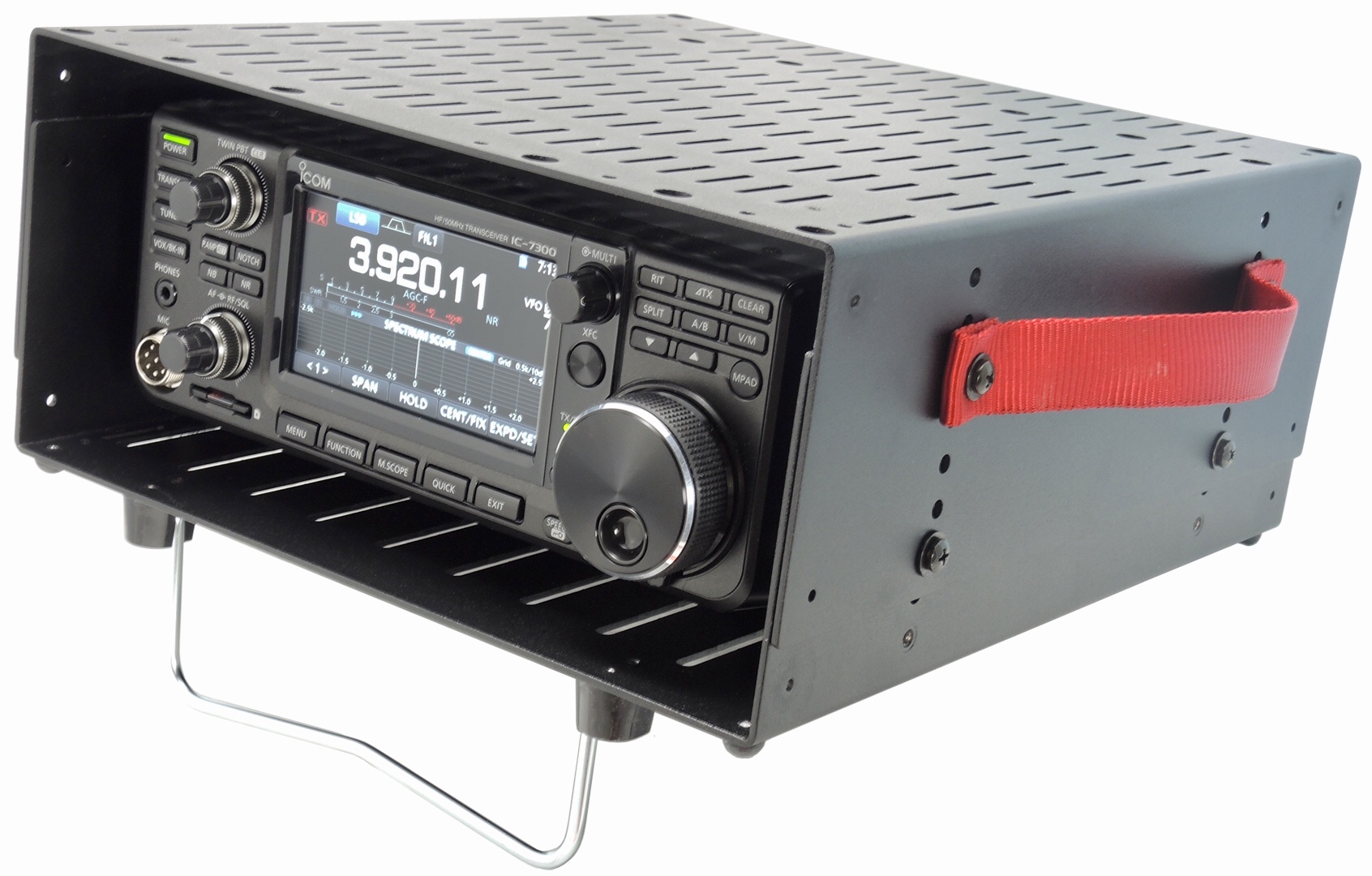

9). All together, the next step is why I find the TAC COMM TRC MODELS ONE or TWO to be the “best” way of making a Rig portable.
Go from base station to mobile and back again as the Radio, Amp & DC Panel are in fixed relation. Always.
F8C4A08D-7DC8-41B4-B71B-EF6CC9564284.jpeg 53F06506-6D08-4847-92E4-97A76B5979BA.jpeg

KL203 is one of a three component heart
