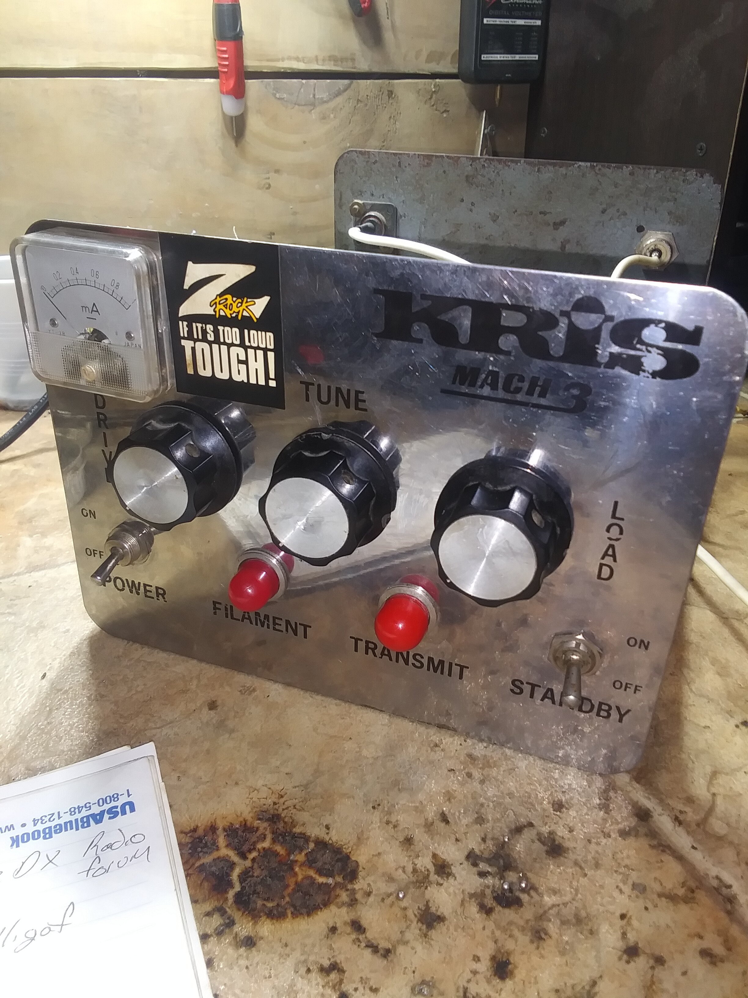

I have a Kris Mach 3 that I bought non working I replaced capacitors, diodes and put good tubes in it and it is working now but not like it should. After turning on amp and giving it some warm up it dead keys about 40w and swings to70-85w but the longer you key down the amp the more the watts will go up. If I key up and hold deadkey a couple of minutes watts will go up to 70w deadkey and amp will swing to 175w but unkey wait 2-3 minutes and and amp will be back to 40w swinging 85w its almost like resistors are draining or bleeding power in standby mode. It is a good amp for long term talking because you can keep watts up but it needs help Any help or comments are welcomed. Thanks Jimbo165

Amp is 1 driving 2 tubes should be in 175 to 200 range have looked for any burned or componets not looking normal but all looks good. Amp will put out correct wattage when deadkeyed for two to three minutes before talking but let amp set on then keyup watts will be in 75 up to a 100w for normal conversation and if you keep using amp as in long term talking wattage will creep up. I have already replaced capacitors , diode were checked and I put good tubes in. Good little amp even now but should produce more. Just wondering if bleed down resistors could cause this? Thanks for comments
old resistors do change their values over time. If you disconnect ( unsolder ) one leg of each resistor then measure across it to get its value. If its far off, then replace it with a suitable value/wattage one. You could even look at the wiring connections. The power supply could also be dropping under load.
