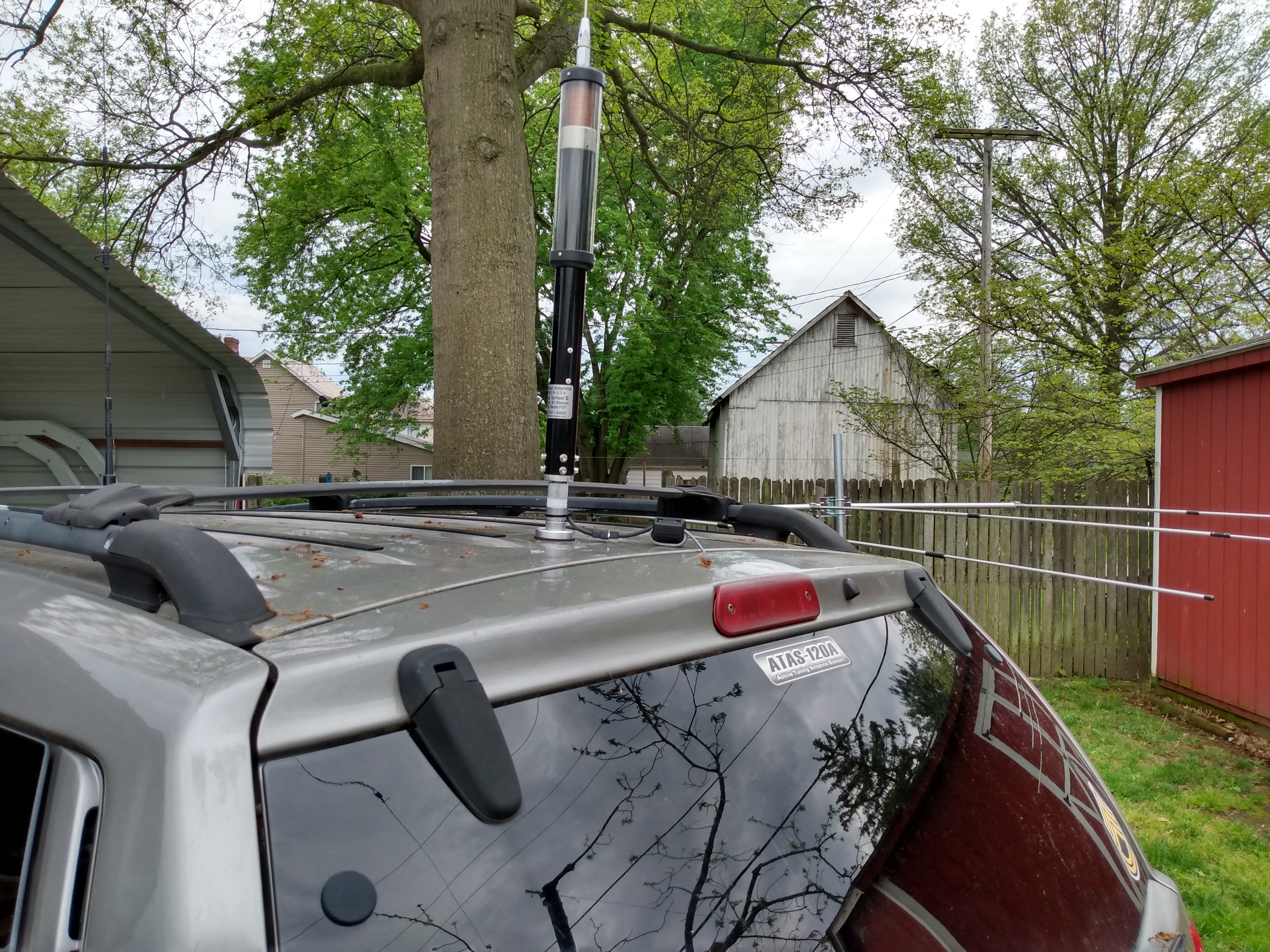

Got my Tarheel installed. Seems to work decently. No problems with grounding. The control cable is good quality along with the molex connecter. The Rocker switch and power leads are lame.
The switch feels cheap. The housing looks like some kid made it on a cheap 3D printer. They give you a short pigtail with glass fuse. The wires are different diameters, which gives it a hokey look. It's just rat nest looking. My Diamond screwdriver had a cigar plug assembly that was clean.
Anyways, the antenna itself is nice quality. Just don't care for the cheap switch and power wires.
Anyways, the antenna itself is nice quality. Just don't care for the cheap switch and power wires. View attachment 37382

I wanted it high. If I could have used the ball mount, I definitely would have. The screwdriver assembly isn't that tall. The whip is thin and extremely flexible. I have a spring on the way that should help with low hanging obstacles.
I'm eventually going to move it to the center of the roof. I already have a puck there. It will sit on, either a foldover or quick release mount. The antenna and radio get power within the cab, from direct wire to the battery. I do have a hitch, but this antenna is to small to be mounted there. It's a work in progress.

The mount I'm using now is temporary. It's a UHF mount with a 3/8" stud adapter. The mount replacing it, will be a 4" Puck mount with a quick disconnect, or foldover stud. I'll be mounting that just above my head. The hole is already there, as I have a NMO Puck mount currently. The 4" mount is secured to the roof panel by four 5/8" bolts. That will provide a great deal of structural strength and prevent sheet metal flexing. I might add a 1/4" backing plate, as well. Just depends.
The mounts from Breedlove are extremely well built. No one makes anything close to what he builds.
