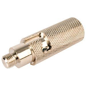

Do they make a quick release ferrule for the whip? I'd like to be able to quickly remove/swap the whip
You got these types CB shops and some truck stops sell. You'll need a set for each whip if you want fast change out.
I just carry 2 wrenches (main wrench and backup) and can change whips just about as quick.
That should work. I see where MFJ ferrules with each having different internal diameter. I need a bigger one for my 72" Sirio whip. It's a thicker whip, but is stout.
I'm always conscious of my whip and low overhead dangers, but the wife isn't. I want to be able to take whip off before she drives. The overall coil assembly is low enough for most hazards. When I relocate my antenna forward, I'll use a quick release at the base or a foldover mount.
I need to remove whip at the house before she drives, otherwise I'll need to carry a stepstool to reach the whip.

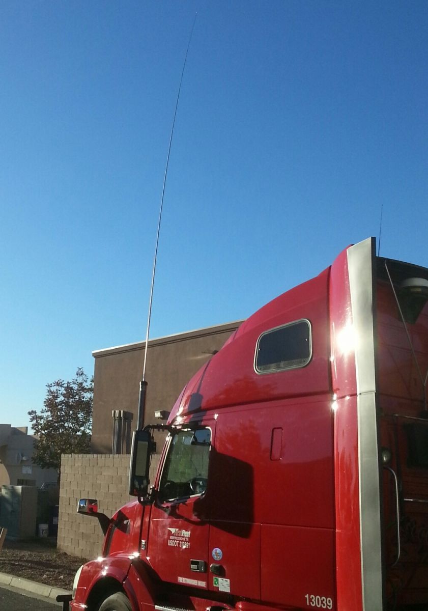

It may look ridiculously funny but it instantly turns your little ineffecient mobile HF antenna into a near base station like vertical.
The MFJ 16.9ft telescoping whip is 1/4 wavelength on 20m. You'll have to collapse it a section or so to compensate for the extra Tarheels length and you'll use just a little bit of coil to tune it. Highly efficient this way on 20m.
You could experiment collapsing the antenna for 17m thru 10m to get near 1/4 wavelengths on each band. Just make notes on how many sections to collapse for each band. It doesn't have to be exact because you'll still need a bit of coil to fine tune it. There are 10 sections on the 16.9ft whip to play with.
Because you can’t run an amp with the Tarheel 2 (150w max) this will be a near equivalent. I checked once with a stock 3ft whip against the telescoping whip with100w on 40m. Nearly up to 2 S units was gained on the other ends receiver. Not an exact science but still shows a significant increase.

6 meters is cool, but it's even cooler mobile. Maybe I can rig up a quick whip change.
A Hustler Quick Disconnect works great.
SIX-SHOOTER
Reactions: Slowmover
I ordered the Hustler QD-1. I'm putting it on top of the Tarheel for quick whip removal until I move the whole antenna forward.
