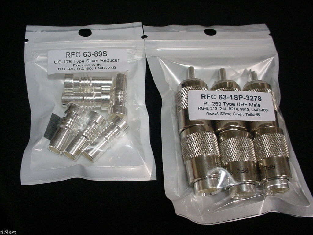

Not seeing much on Amazon or Feebay. Anyone got a source for small bulk packs?
I prefer the ones with soldered center pin and crimped shield. I have a bunch of regular solder connectors, but the reducer won't slide on my LMR-240 UF. Package says it fits 240, but not mine.
I got some of these silver plated ones from eBay. They looked OK, but the thread pitch seems different and won't thread all the way on and the real of the plug is loose and spins in the socket. I wanted to use the lot of regular PL-259 solder connectors I have, but the reducers won't fit my cable, even with lube.
My US made LMR-240UF cable, has a rubbery jacket that must be thicker than most
Guess it doesn't save trying to be cheap.
