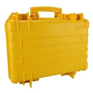

Planning to get something like this case and put radio, tuner, power source in. Might be able to fit a coil of magnetic wire in too. Besides I'm probably not going to wander too far from the vehicle. :D
