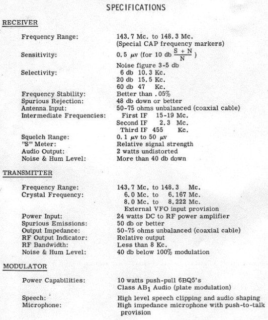

That's a Gonset Communicator IV. A 2 meter AM Transceiver. I used to own one, in fact it may still be somewhere in storage.. I don't remember ever getting rid of it.
well i have heard it receive and i transmitted into a 50 ohm load .this ol girl works great .i have no idea where its transmitting ?
i dont recognize the freq`s on those crystals .can anyone help with that??
Try multiplying the crystal frequency by 18. That's essentially what had to be done (two triplers and a doubler).
