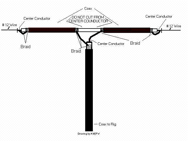

Looking at antennas and found this.
it looks like a standard 1/4 wave dipole. It's too easy to build for yourself. Why not save money and make your own in a few minutes?
I think you mean a 1/2 wave dipole. No such thing as a 1/4 wave dipole. The double bazooka uses coax cable as part of the radiating element unlike a normal dipole. Still easy to make as long as you waterproof the cable and joints really well. they work about as good as any other decent dipole, maybe slightly better,
Lots of 'stories' going around about 'bazooka' antennas. They are basically a 1/2 wave dipole with a different method of being fed. It's been around since the 1930's - 1940's, first used as a radar antenna by the military. Most of the 'stories' about them are more myth than fact.
The 'biggy' for most people is that they tend to have a fairly constant SWR over a wide range of frequencies. What that does say is that their efficiency drops the further away from the design frequency you use it. SWR stays about the same, but efficiency drops. That's because of the way the thing is fed, each 'side' is a tuned circuit, almost like a gamma match, sort of. That 'tuned circuit' tends to add reactance as it moves away from it's design frequency so that an SWR meter tends to stay in a 'better' reading longer. The bad part about that is that reactance doesn't radiate anything so that what get's radiated tends to decrease as reactance is increased.
There's also a myth about it's power handling ability. It actually has less power handling ability than a comparable dipole made from the same sized conductor as the bazooka's center conductor. There's nothing 'magic' about it, but they do work.
If you can find one of the early ARRL 'Antenna Compendium' books there's a very interesting study done about them. Several different feeding methods, and other changes done with a bazooka antenna, and how the measurements for them are arrived at. And then there are the mechanical draw backs to consider. Since coax is used, they are heavier than a 'regular' wire dipole.
Wanna try one? Do so! They really do work as well as a 'normal' dipole. Just don't think that you've got some kind of 'miracle' worker, they aren't.

That little extra matching inefficiency gives you the added false sense of wider bandwidth.
Also, depending on how stout it is built will determine it's survivability in the horizontal position. They'll play just as well and survive longer if mounted as an inverted V.
I would only erect one over a standard traditional dipole if I found one, or was given one. I certainly wouldn't build one and I would only use it long enough to be replaced by a regular "dipole".
Another interesting factoid most people overlook is that the Bazooka is also a resonant closed loop, which helps decrease harmonic radiation & noise.

I am getting up for work and having coffee, WOW thanks for taking the time for posting great answers to my question. I have more reading to do! I know there is no " Magic " or " Quiet " antenna And I still want to make or buy a wire antenna that works. Out of all the wire antennas what is the best to put up. A simple dipole, Balun or no balun. and configeration, Inverted V . I can buy a simple dipole with a 1:1 balun for about 35.00. And that would be easy for me to screw coax to and conect. CBradiomagazine did a nice test on a wire antenna as well.
Thanks for all the help and your input. " wire antennas always seem like a mystery to me!
