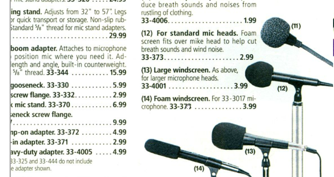

Shoot, well, I had a bunch from Radio Shack days - they were used for their "Telescopic" Unidirectional Boom mic -
Considering the head was about a lot like the diameter of the Astatic EchoMax2000(?) element - you just scissor off the - tail...

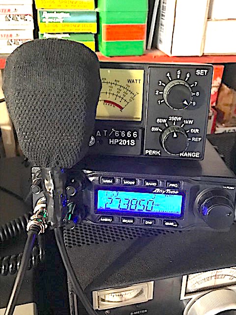

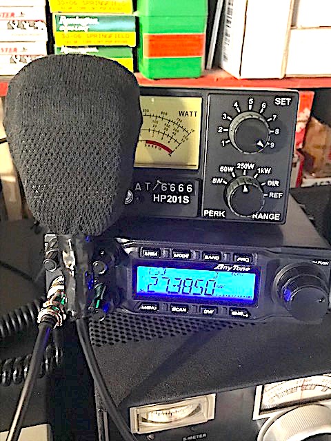

The mic picked up a "pfttt" sound. Didn't want to take the mic apart and put foam inside. I tried foam on the outside and that piece of thin sock over it to hold foam in place. That worked.
Also found out by "radio checks" the sock worked better minus the foam. I was told the foam inside eliminated the "pfttt" but the audio was somewhat suppressed. Took the foam out. Been wearing socks ever since. :whistle:
