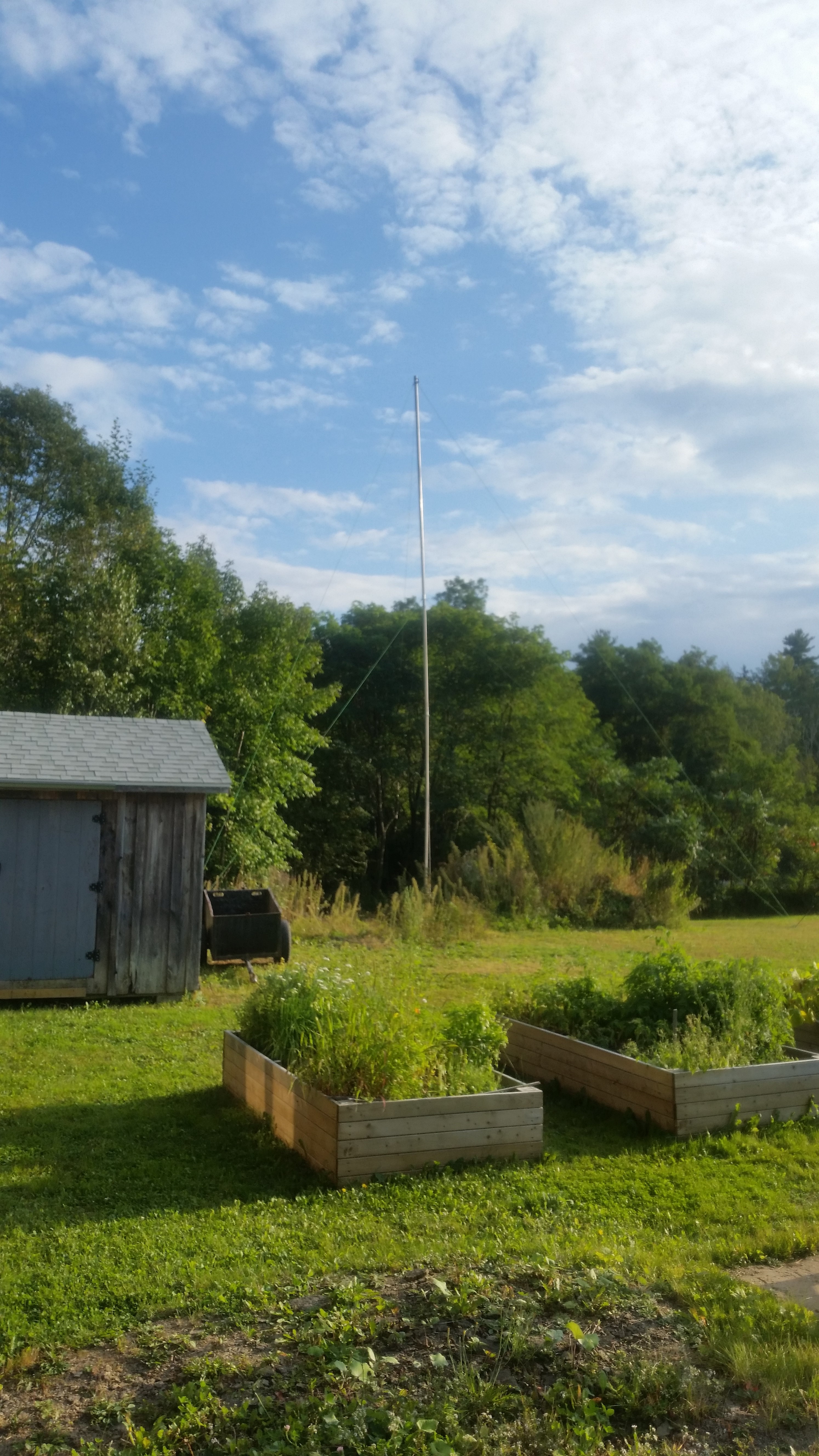

Well I did manage to get up the tower but paid the price for it.......and still am. Things went better than I thought going up but later that night I beginning to question the wisdom of having done it. :confused: Oh well it is what it is. I managed to get a full size 1/4 wave inverted L for 160m with about 58 feet vertical and 70 feet horizontal sloping from 60 feet down to 40 feet at the far end. It was to be fed with an automatic tuner at the feedpoint for all band use but the match was WAAAAY outside the range of the tuner on 80m,40m,20m, and 15m leaving me with only 17m to play with. I cut the wire in half and ended up with a decent match on 80m but again no other bands would match. Oddly enough the antenna analyzer showed R0 j1200 on those bands where the antenna was 1/2 wave or multiple thereof where it should have shown hundreds of ohms of R or even over range at 1500. I also installed a bypass relay so I could bypass the tuner when listening on the longwave or AM broadcast bands as well as if running 160m where I had a decent match without the tuner. Got POed after a while as nothing seemed to work so I placed an order with DX Engineering for a Hustler 5BTV vertical along with theDXE-TB-3P tilt base, theDXE-AOKB-17M 17m add-on kit and DXE-AOK-DCF direct coax feed assembly. It should be here either this afternoon or tomorrow. I am also working on building an 80m trap to install in the inverted L to allow it to be used on 80 and 160m and it should provide better performance than the 5BTV on 80m. I go back to work tomorrow for four days but than I am off for twelve days so I hope to get everything installed then including a good radial field. I plan to build radials with lugs in the evenings after work to have them ready for when I am off. I will keep the 5TBV after I get antennas on the tower and use it either as a spare in case something happens to my yagis or to use when signals are good and I don't want to constantly turn the rotator.
