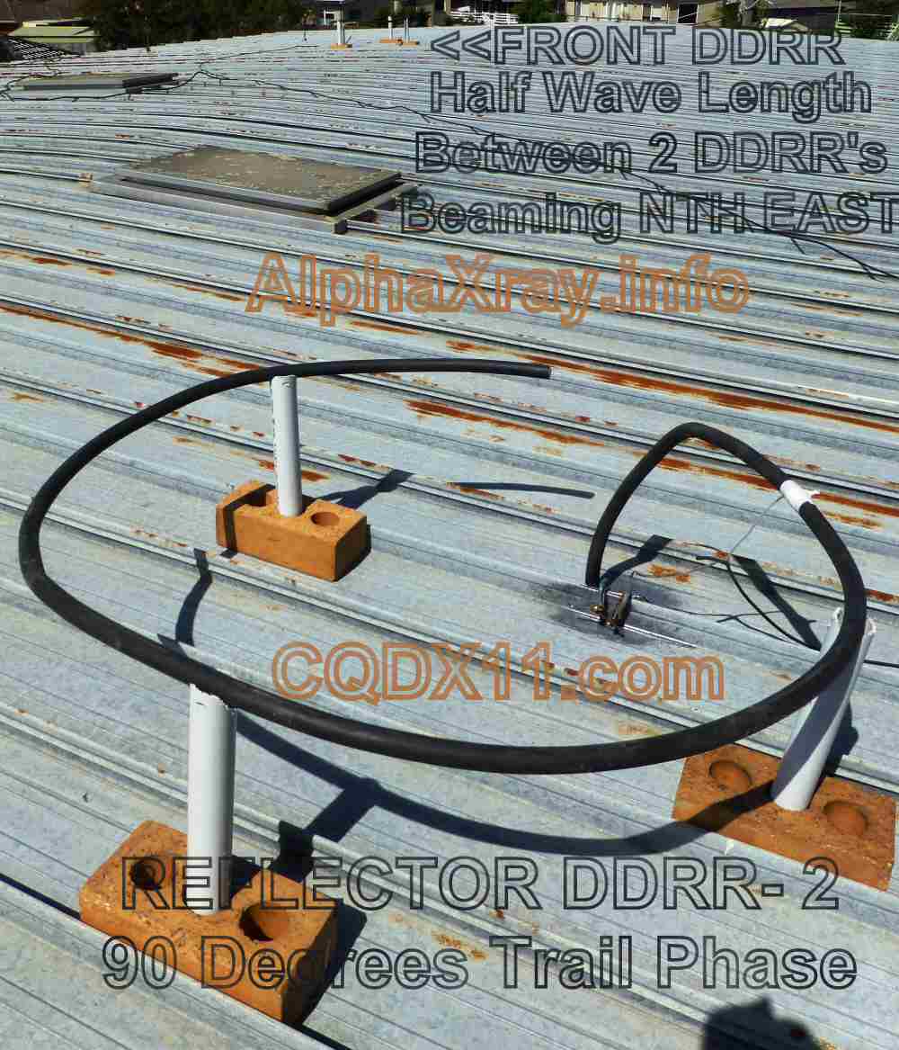

And the DDRR

I never could get the DDRR to model well, even if I used the double variant of it and mounted it in any number of locations.
