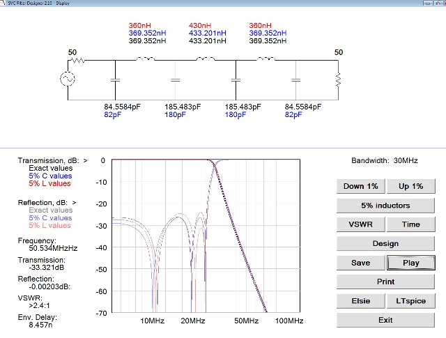

Try a 7th order filter designed for 30 MHz, C-input Lowpass, Chebyshev style
Here's what SVCFilter shows for that:
Now see how nice that one is?
