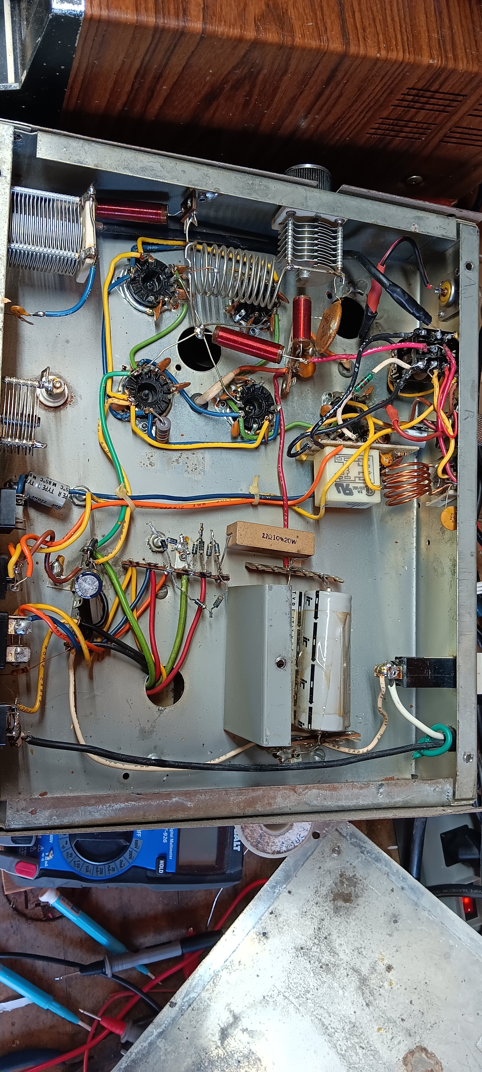

Hey, just the subject I need. I come up with a Maco 300, and could use a schematic that matched. All I have is the one from cbtricks. This one has 5 tubes and 1 trans.
Here's the rundown of a 7-tube version we converted to six. Your specimen has a grounded-grid (cathode-driven) driver stage. Much better than the grid-driven version. You'll need a small radio to match that single driver tube. A Cobra 2000 busting a gut to swing 15 Watts would be about perfect. A single driver tube just isn't compatible with a modern radio that has two finals. Was no such thing for the designer to worry about in 1976.
