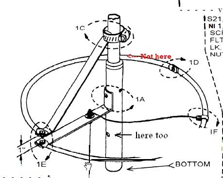

I think they were trying to show that the length of the antenna begins at the bottom of the base and not where the first knuckle is-
That makes sense Sonwatcher; seeing that diagram with the arrow pointing to the bottom, which leads me to now believe the VERY bottom of the antenna as shown by the arrow. Why don’t they just state the very bottom of the antenna or very bottom of the base assembly, why even bother mentioning “below the C13P mounting hole”? Just doesn’t seem necessary. It was always confusing to me for some reason, but I went by the very bottom anyhow. In all honesty I don’t remember seeing where it showed BOTTOM with the arrow pointing to it when I was going through the manual. I just rechecked my old original paper copy and it shows that too! I was a bit overwhelmed when I originally got the antenna & seen all the parts that needed put together, so I must have overlooked that detail. I was 13 or 14 years old at the time & it was a project for me! Not as simple as my cousins Solarcon A-99 we put together in a couple minutes with no tuning required. Thanks for pointing that out. I’m surprised after all these years I never noticed that or don’t remember noticing that.
I still don't know where the bottom is either. It could be either of the two points on the bottom of the base noted below I suppose. I don't believe it's at the top for sure.
I understood that it was measured at the hole where the bolt goes through to mount it to the mast. It worked for me and I had no problems what so ever tuning the antenna. I think if one makes a mistake and measures to the very bottom then it is only off a few inches and still should tune pretty quick. I think it is more important to get the measurement right on the hoop of the antenna than the length.

I was reading through my manual again to see what all was covered, & on page two in the BASE ASSEMBLY section it states:
“Note: Overall length is the distance from the top of part T01P to the bottom of part BA1P.”
The top of T01P would be the very top of the antenna as T01P is the very top tube.
The BA1P is the very bottom tube of the base of the antenna & is what mounts to the mast (& the tube in my photo above), & since they state the bottom of the BA1P I think there referring to the very bottom of the antenna.
Meaning once the antenna is assembled & ready for overall measurement, you measure from the very bottom of the antenna (very bottom of the BA1P) to the very top of the antenna (tip of the T01P).
With the figure of the base assembly where it has the arrow pointing to the BA1P tubes bottom, I think that’s what there referring to as the bottom. But I am still a bit confused how they word it in different pages of the manual & why they mentioned anything about the bottom is below the hole for the C13P clamp. And no real good illustrations of the measurement points.
I had absolutely no idea when I originally put the antenna together, but after seeing some of the stuff you guys pointed out in the manual & me re-reading it again, I think they are referring to the absolute bottom of the antenna once it’s assembled, but that’s how I am taking it in & I could be wrong!
I’m glad I seen this thread, maybe I’ll finally understand that part of the manual so I can do it properly.

621, my instructions does have the Note:, but it is written "The bottom means the very bottom!" However I still ask the question, "...if you mount the base inside of your mast how then do you tell where the bottom is?
My instructions also tell you to slide BA1P down inside the mast about 6" inches and secure it also using C13P clamp over the mast. With such an installation it would seem there is likely enough antenna material in the mast to make for good support.
However when you install the mast inside of the BA1P base, then there is only about 2" of mast used for support, and IMO that seems to be a bit shy of good support at that point. I also think most installs are made in this manner---with the mast inside of the BA1P base.

Very good info 621. The only physical difference I see between the new manual and the old is CE's only suggest the single mount idea where the mast is installed inside of BA19. The wall thickness of the tubing is also thicker @ .050". That may have some affect on the overall length dimension, but it would surprise me if it was noticable during tuning. The 27.0 mhz length of 248" seems to be a bit long and it is way out of portion relative to the other frequency differences noted between 26 and 33 mhz.
So, I'm still not sure how the new V58 length will finally tune out, but Maco still shows the arrow to the bottom being the very bottom and I would agree that is the point they mean for the bottom. One thing is for sure, your observations are correct, you had to go longer when starting at 240". However, if you had been measuring at the bottom of the bolt in C13P you would have been close to where you ended up in overall length while using the 240" inches and measuring from the very bottom of BA1P.
