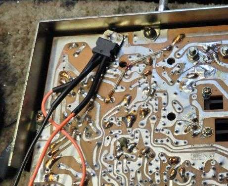

The voltage regulator on the PLJ circuit board tends to overheat if you power it from a voltage much above 10 or 11 Volts. We adopted the habit of using a TO-220 3-terminal regulator like the 7808T to power the PLJ in a radio. The tab solders to a suitably-large ground foil. Black wire to the PLJ power socket goes to the center pin, the red positive wire to the right-hand pin. The left-hand pin is the regulator's input and goes to the positive side of the big electrolytic filter cap. This pic is not from a 148, but it conveys the idea.
