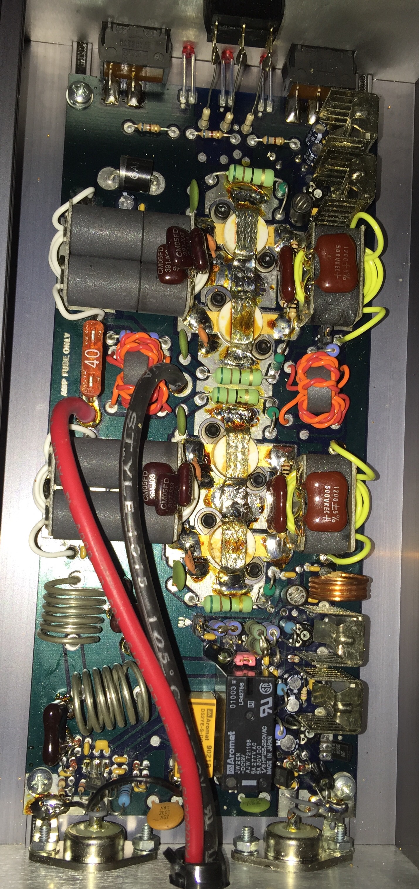

First let me say this is a great place for mean to learn. I have spent hours browsing and reading. Now to the real reason I'm posting. I was recently given a bunch of cb/ham equipment, one of them items was a Ranger AR 3500 with a Magnum 6000 mounted on top of it and connected to the radio. I have found a lot of info on the ranger but not so much on the magnum. I have took pics of the inside of the magnum hoping someone can tell me a little more about it. Thanks

The Jumper on the board is set on the HI pins. There is no way to tell if the radio has been turned down by looking at a picture, you need to put it on a meter and a dummy load to determine that.
Just some observations..........
The balancing resistor on the output combiner looks good, tells us that both pairs have been playing well together.
The input resistors on the power switch do not look scorched , you will see these that look overheated from too much drive, often the death of these amps.
The 10 ohm resistors on the transistors look good, by that we can assume that the transistors are good.
A lifetime ago I sold a few of these amps, everyone I have ever seen used allen head screws on the original transistors, like this one.
They often had a lot of flux on the board as this one does.
I think it is as it came for the guys building them.
Anyway, if the radio shop can not explain what he is talking about, i would walk away with the radio/amp in my hands and look elsewhere.

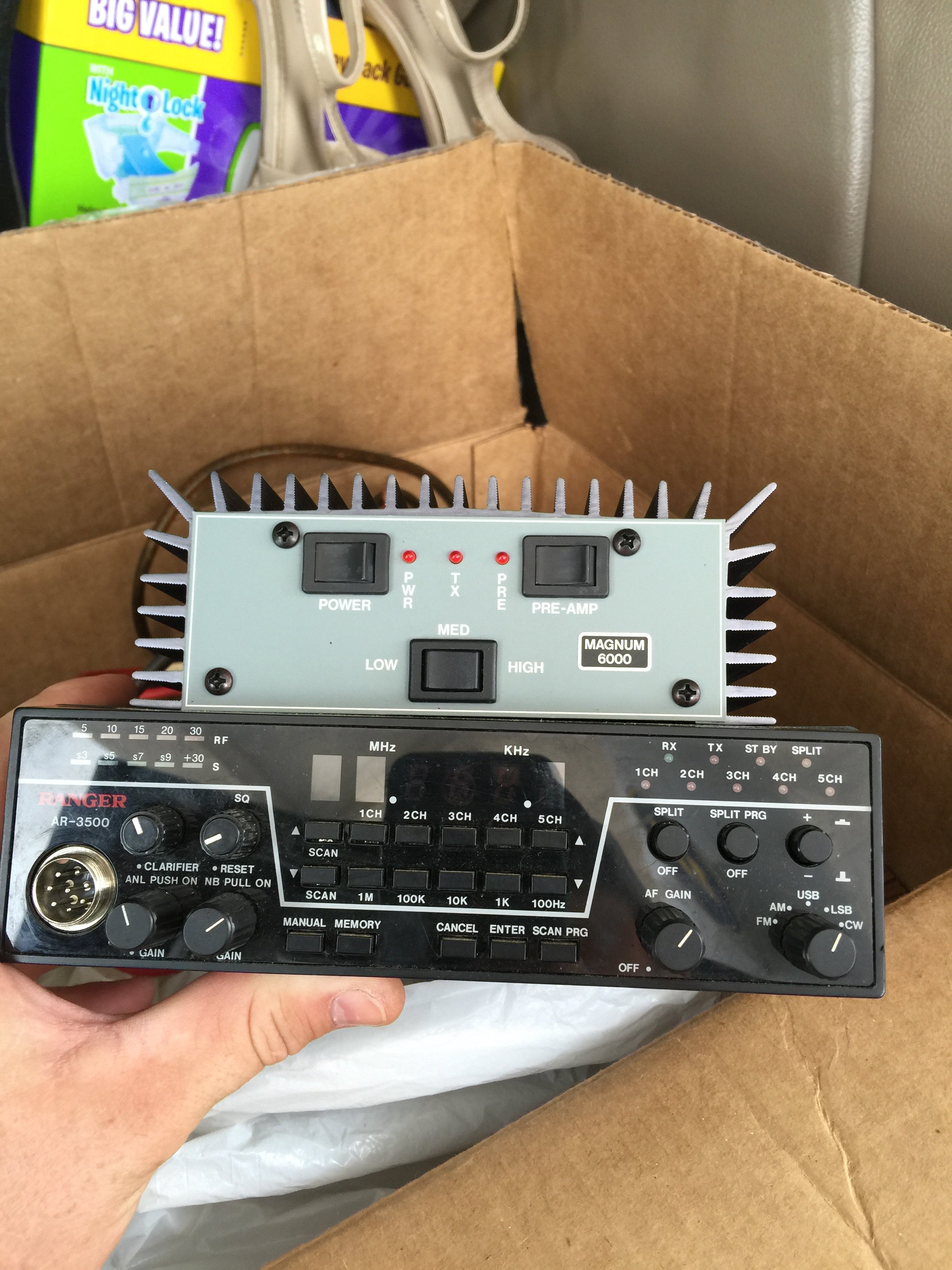

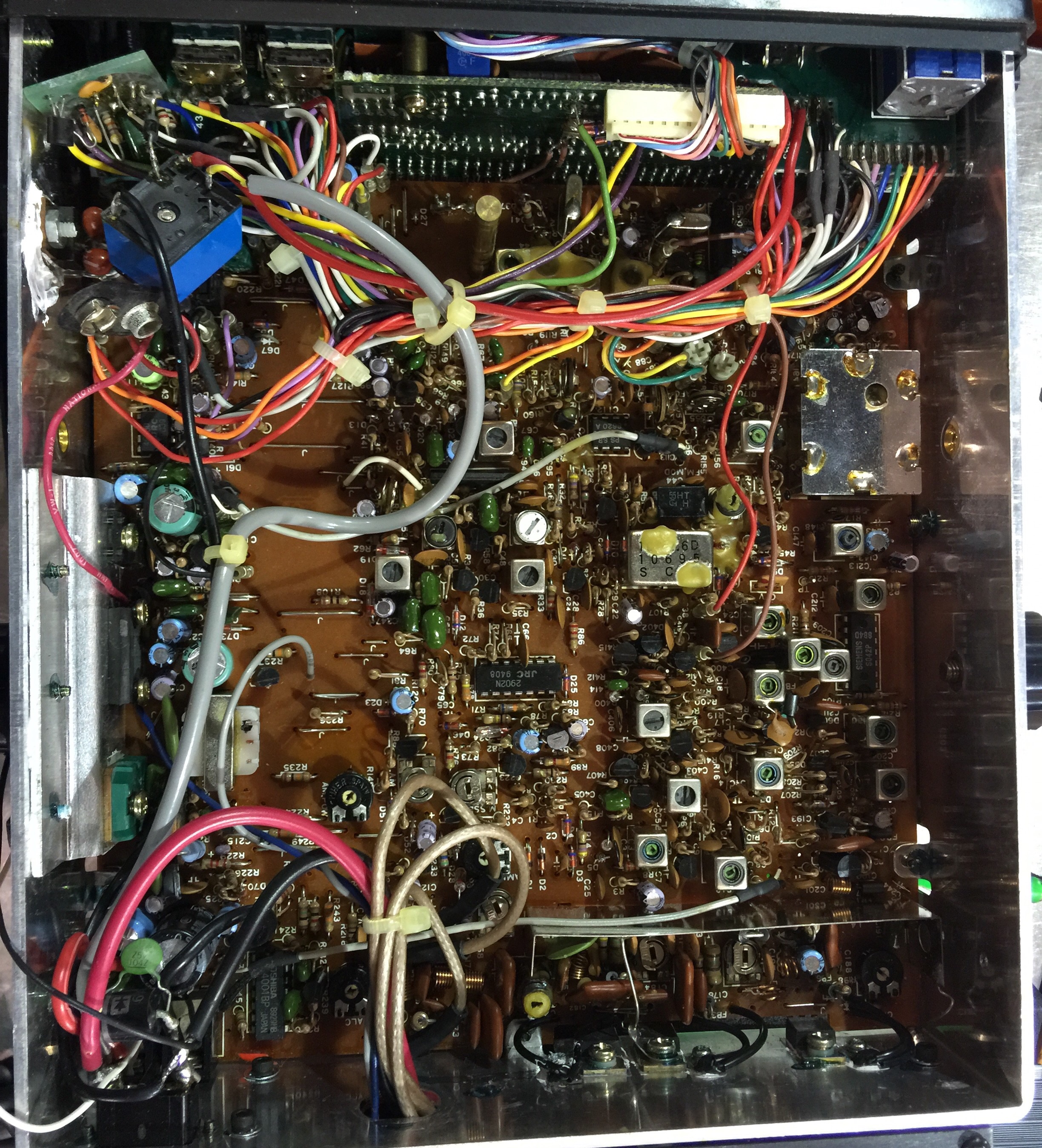

I have added a few pictures of the ranger. I am also looking myself to see what version it is.

You have the 100W version of the Ranger AR-3500. That large heatsink in the back is the 100W PA for the radio. Chances are, the radio may not be matched to the amp, so I would NOT run the amp with this radio.
You'll be able to check output by hooking in a wattmeter between the radio and a dummy load or antenna. Look for approximately 80-100W output on SSB. Let us know how you get on.

It just so happens that I was given aN ultratec srw/watt meter along with the other equiptment. So I hooked up the ranger to my srw/watt meter and I am seeing 30 watts on AM and looks to be about 70 on SSB.
So it looks like I might have too much drive with the radio, and that's why the shop didn't go any further.
Yep, that sounds about right. 30W PEP max is all you need going into that amp. That AR-3500 is a fine radio all on its own, no real need to put an amp behind that radio. The amp will do you better with just a standard AM/SSB CB radio that does about 20W PEP. :)
