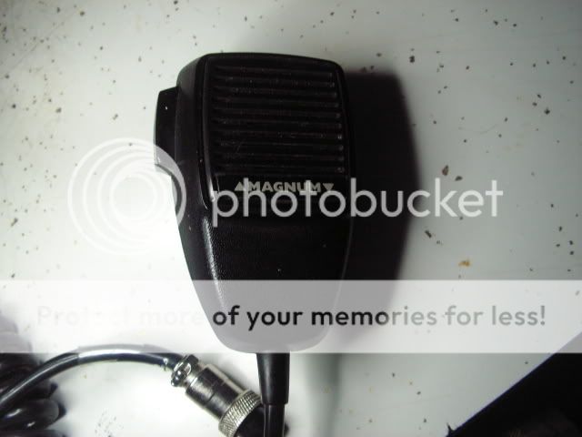

I did say the stock mic can be adjusted internally for maximum output. I will show you how this is accomplished. Here is a picture of this powered condenser mic. Notice the two arrows to the right and left of the "MAGNUM" here? Pushing either arrow on either side will make the radio go up or down a channel. You wouldn't have known that function is there - unless you read the manual. Most mics that have this up/down feature have two easily seen buttons on them - like the RCI radios do.

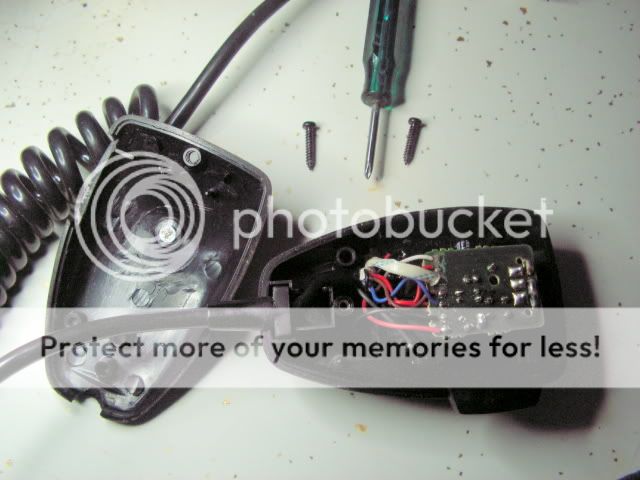

Two Phillip screws hold the halves of the mic together. They will both come off in a jiffy. Or even half of a jiffy. The large hole on the back of this circuit board -near the center- is the adjustment hole for you jewelers screwdriver or nylon screwdriver. You will need a flatblade screwdriver for the adjustment.

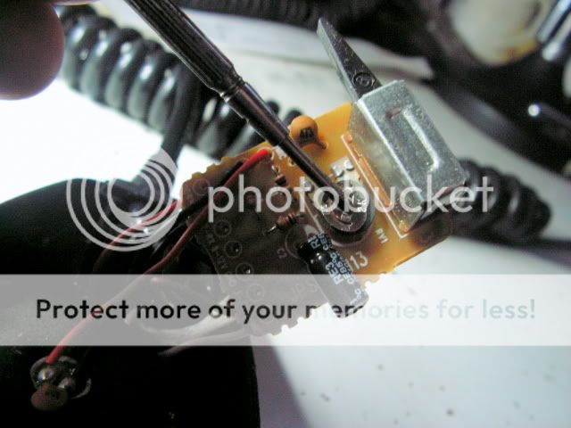

This jewelers screwdriver points to the pot that needs to be adjusted all of the way up. You don't have to pull the board away from the mic as I did. I just did it to show the parts. If in doubt as to which direction is all of the way up; plug it in and key the mic and turn it until it gets loudest. Be sure to turn it all of the way up! Use the talkback feature on the radio to monitor the volume change upward. Reassemble the mic and pop the two screws back in.
Done!
For a stock factory mic, this isn't a tosser that will end up in the box with the rest of the stock Cobra mics. It is really quite clear and has a very wide frequency respone. It also has a very hot output. You can get the talkback volume pretty high with this mic before it feeds back. On-air reports have told me - this mic is no wimp!
