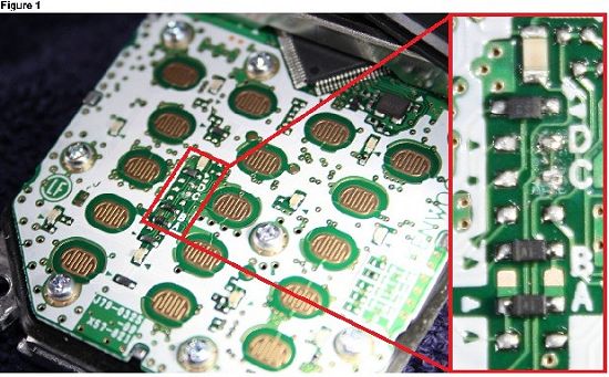

Locate and carefully remove both Diodes reference C & D from the TX/RX unit - (see Figure 1).

have new th-k20 fm trans removed diodes d an c done full reset but only can do 144 up 147 are there another diode in new ones that has to come out to open
I have exactly the same problem.
After running unrestrained for 2 years, my TH-K20E radio clamped down to 144-147MHz.
My radio behaves like an M type radio
Does someone have an idea ?
Well done and huge thank you to the one who will give me the solution!
