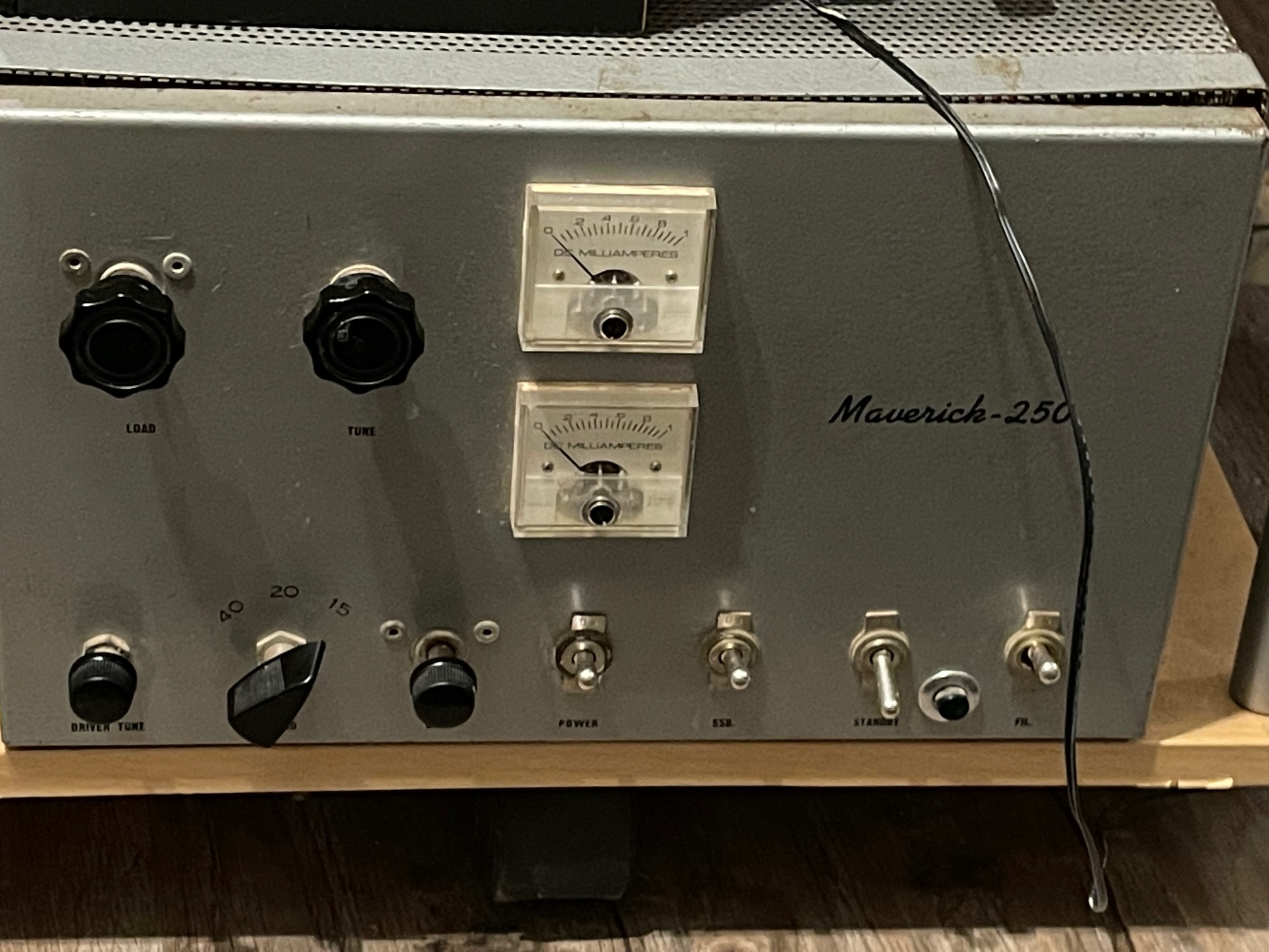

Two relays. Guess it to be a pretty early version as it's a two prong ungrounded plug. And while it is not marked on there for 10 the knob does in fact go to four positions.
The second Maverick I have has a two prong grounded plug, 'D & A' in the meter backs, a two way toggle marked for 40-20/15-10, a grid tune knob and a switch simply marked BF (no clue). I do believe there is a tan fronted one that looked similar to the PDX 400.
I imagine the band knob should be pretty universal though but there are things with this one that doesn't match a lot of what I see out there.

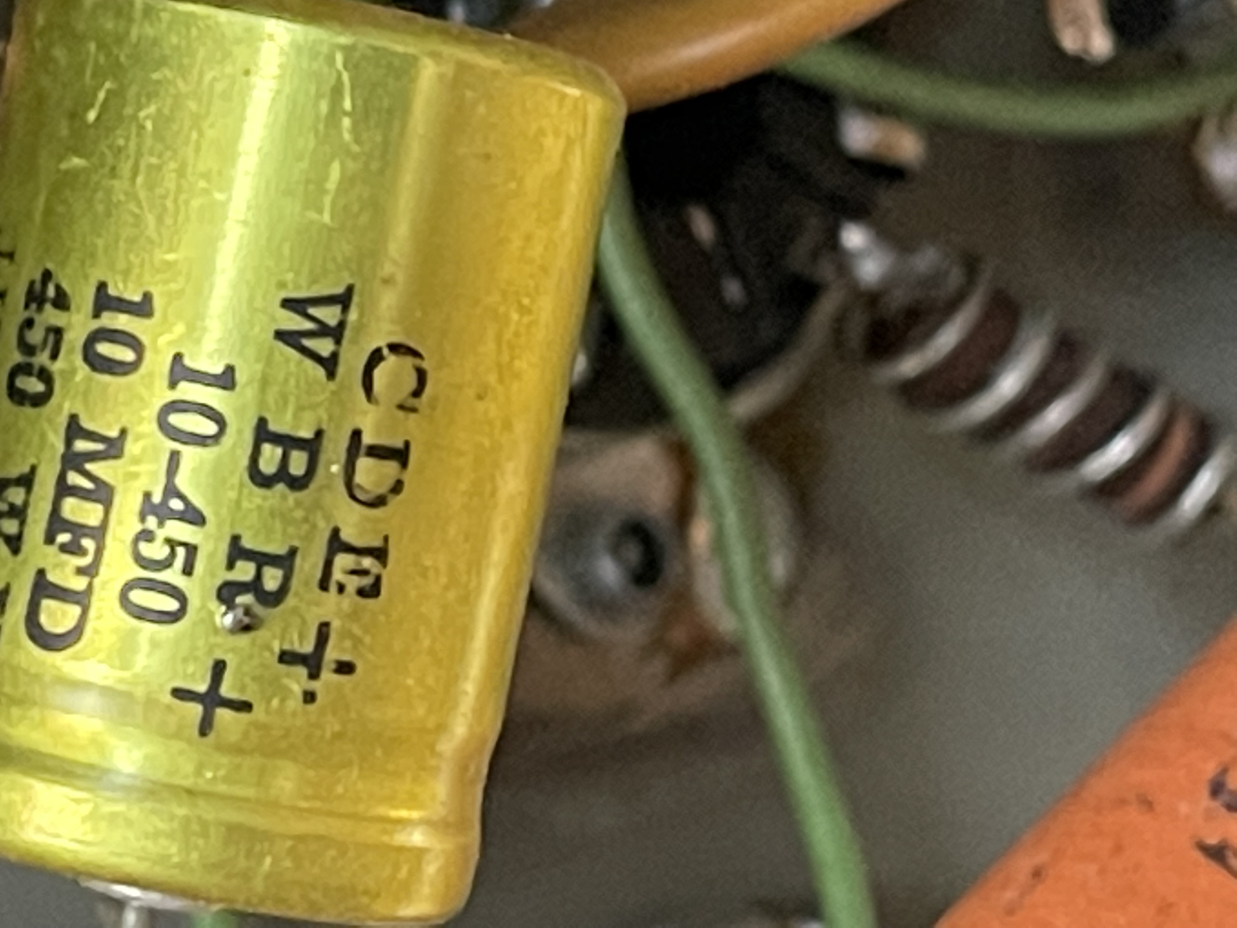

After playing with it a bit and matching it with my good working one I was able to determine the switch has been at least somewhat bypassed. Looks like they took the wire from the 15 meter switch and moved it over to the 10 meter part of the coil thus the empty solder point. Also looks like for some reason they took either 20 or 40 out as well. Location is correct for 10 meter but not sure about the top side yet. For my guess is if they went this far they moved the other as well but haven't made it that far yet.
I also notice the key circuit does not match the schematic as my key circuit has a 10/150 cap in place and this one has a 10/450 cap there - considerably larger. Tried placing the normal one in line but the relay would just engage upon powering the circuit so put the current one back in place. It is definitely not an original but as it seems common with these Mavericks no two really match each other but a much more modern looking component sticks out.

The keying circuit in this amplifier is a bit like holding a broom upside-down in the palm of your hand. Some tubes won't want to release when you unkey the radio. Another tube in the same amplifier might be less sensitive and want to chatter the relay.
The drastic change you saw from changing that capacitor illustrates the sort of demented equilibrium that makes a tube-type keying circuit do its job. Well, both of them. To key when there is a carrier, AND to release the relay when there isn't.
A transistor is a better choice for this, but you would have to change the antenna relay to use a lower voltage. The relay used with the keying tube requires voltage too high for transistors.
No cheap and easy answer for this one, unless you persuade the original setup to be reliable. In that case, it ain't broke. No need to fix.
