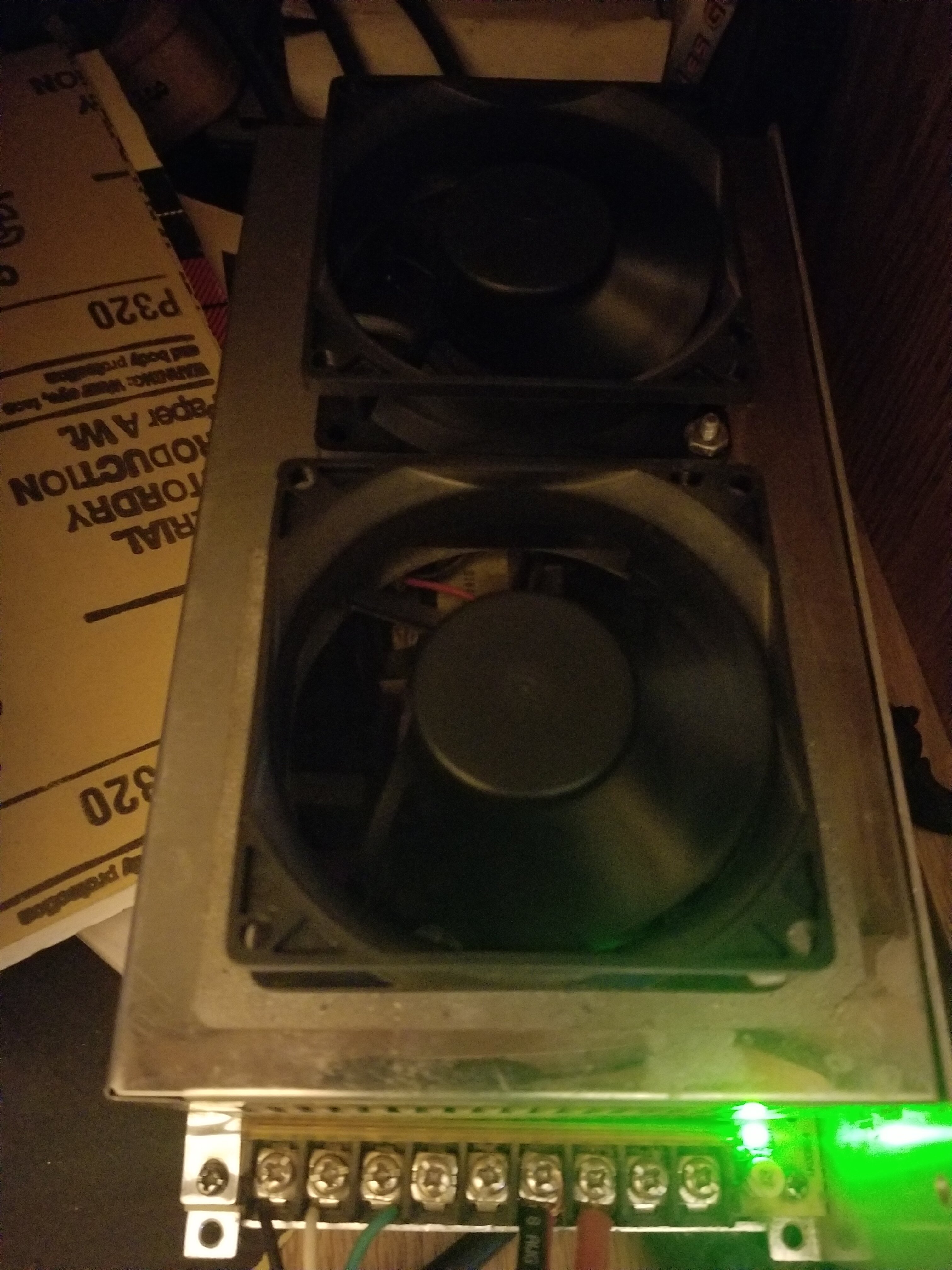

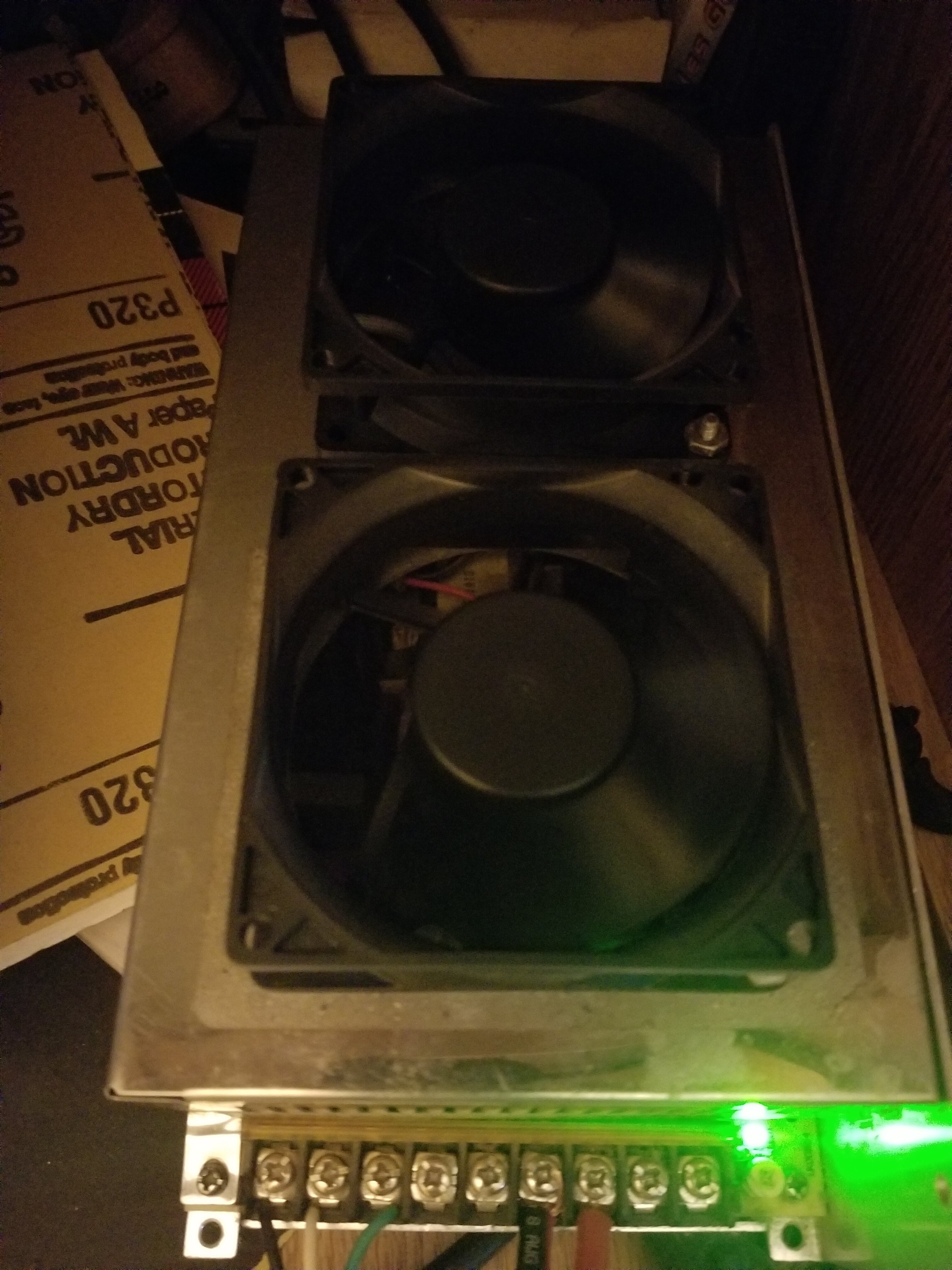

They are putting resisters inline now? I went with 2 12 volt fans in series. Whisper quiet and still moves a good amount of air.View attachment 28588
Similar to what I had in mind. The 5 volt 120mm fans I use on my amps are barely perceptible to my ears. I'd likely only need one, but I'm sure yours stays cool. I want my supply to remain on 24/7.
