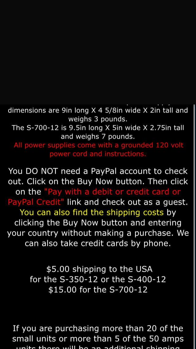

Shipping is $5 for the 2 smaller units and $15 for the 50 amp unit. Per the web page.
If this is what you were wanting to know rabbiporkchop.

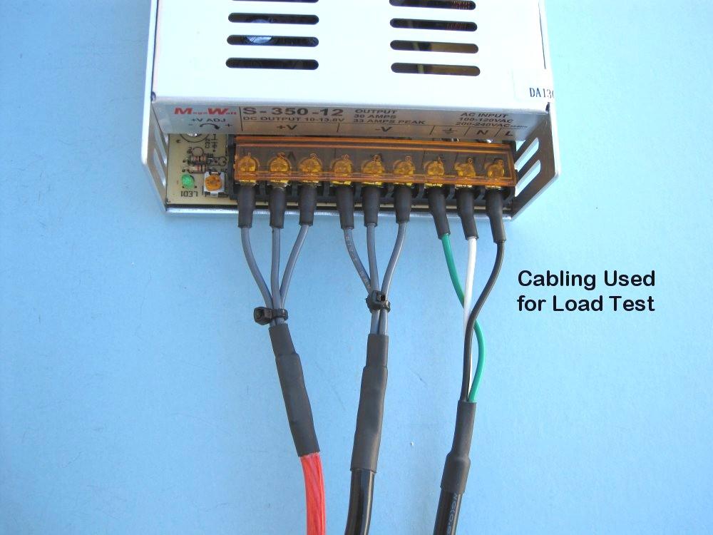

just a question, on your higher amp models (well, actually all models), there are 3 lugs for + and 3 lugs for -.
are all 3 + lugs tied together on an internal "buss bar"?
same for the - lugs too?
my real question is, on the 50 amp supply, is one + lug rated for the full 50 a load, or should all 3 lugs be tied together on the load side using a 3 lug harness and then to the load?
like this

On all models even the S-700-12 one of the three screws can handle the full output.
As in our S-700-12 video only one of the three outputs is used to pull 50 amp from each of the power supplies.
