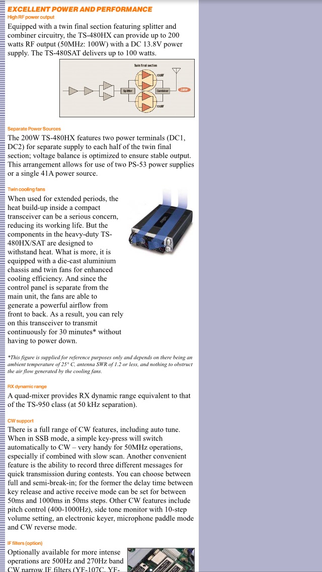

Ok seen a TS-480HX pulls @30 or less and is doing @200 watts. Am stumped thought they need about 20.5 amp per sidemakes 41 amp.
Don't know how this is relate to the actual thread but you're correct there Heavy Metal. If you read the specs for the 480HX it's shows 41 amps total needed or 2 PS-53 supplies which I assume are kenwood supplies. There are 2 sets of power terminals, each set of terminals powers 1/2 of the twin final section. Either way it needs 41 amps total. Here is a shot of kenwood's breakdown of the radio.
Read where it states what I said above. Hope this helps. The regular 480HX 100 watt version will or should pull about 20-25 amps I would suppose. Again hope this helps.

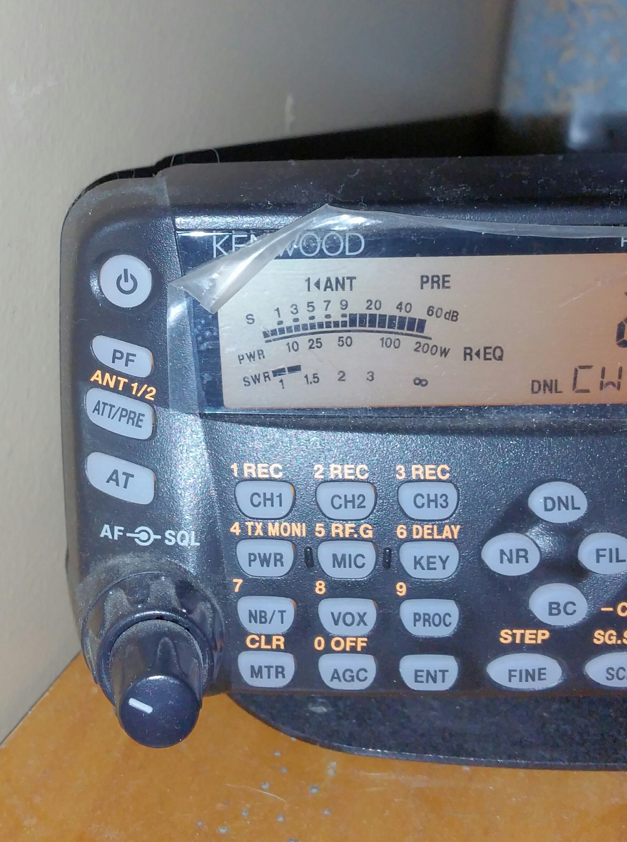

I thought so too. But when he put it on cw sure enough, why I was wondering why radio and the 989D read 200 and power supply was no were near 41amps unless amp.meter is way off?

Capt K, it shows what the brochure says wattage wise on the TS-480HX, also says on power up twin power, so both leads are HOT, at least the radio senses it but, on all bands it shows give or take a watt to 5 watts on like sidebar but power supply meet says 20 to 30 some odd amps. Not even close to 40 and it's a 50 amp supply set at 14.2 volts each side acoording to 2 separate external meters. Just curious on why yet 989D meter shows full power from radio thru the tuner meter even radio meter is toe to toe with it. Just again curious.

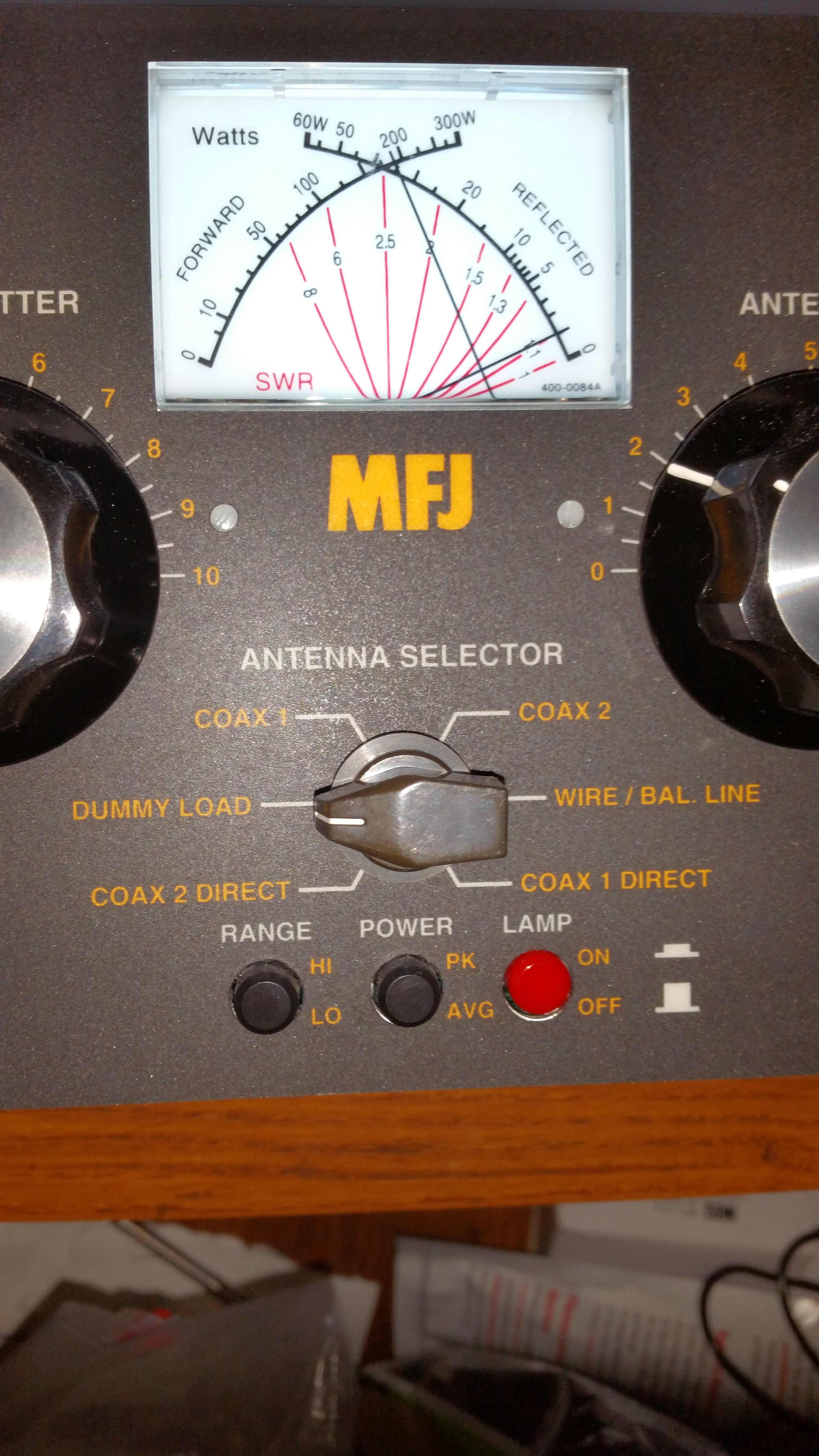

OK I put the MFJ-989D on dummy load. Here is what I got.
Do me get me wrong on this, it's all nice love the tuner, if I was to rate it at what I do and put into it I'd rate it a 9.5, need a few wire antennas and more power and I'd give it a 10 if does as well as this, just weird it's almost dead on with the radio, yet power supply is reading low, but accuracy of the meter on the Tuner got me wondering. And I am at 175 I don't push the 200. But on ssb it does swing 205 - 215.

That would be the bomb lol, but not my luck lol, but I posted pics above at a 175 watt key down into the dummy load.

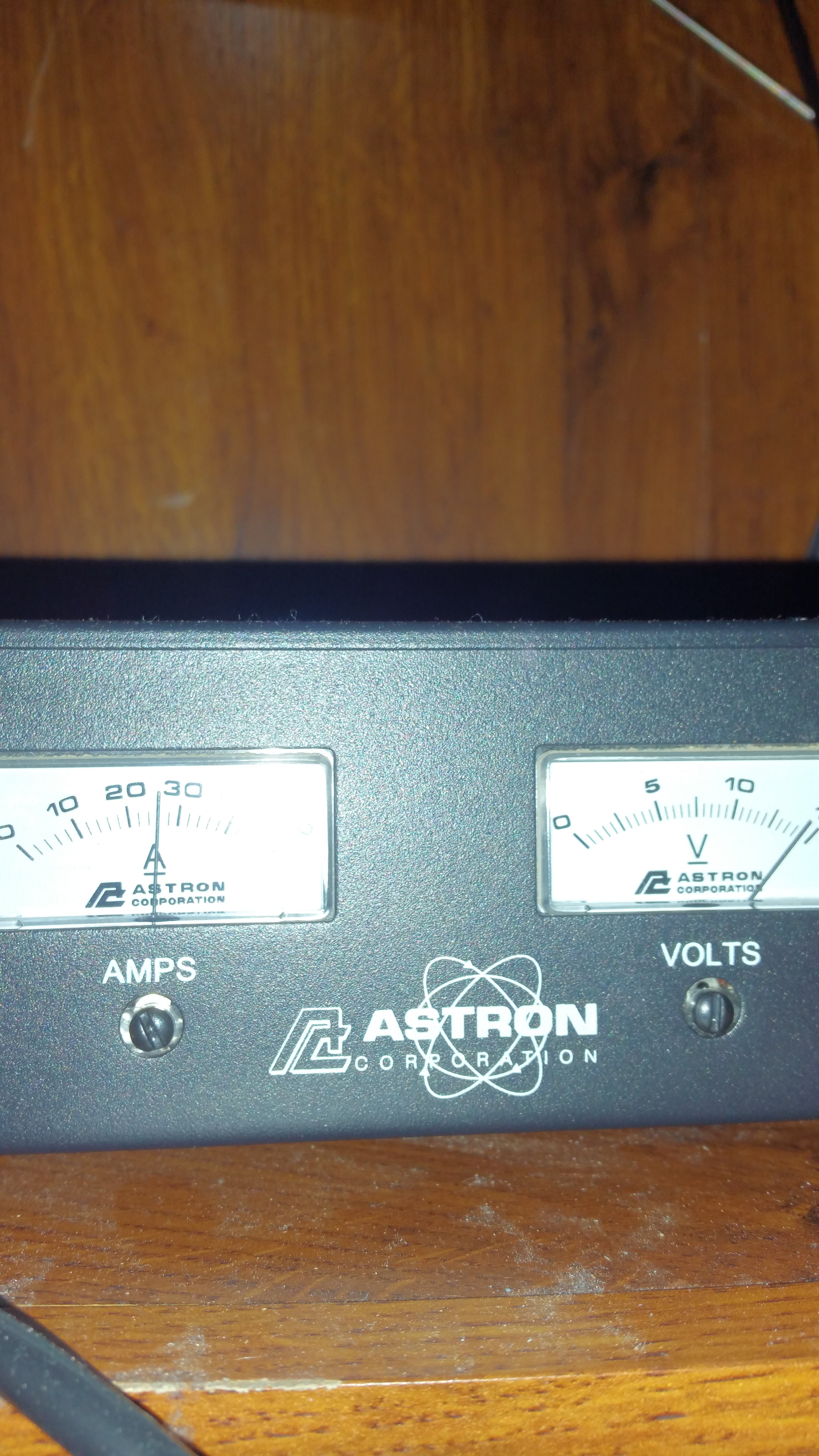

Hey, maybe the meter is low on the Astron?

I think it's going to be a guessing game but I'd guess the Astron meter. I have an older Pyramid supply that always reads low on the amp meter. It never bothered me since the radio is doing what's it's supposed to.
