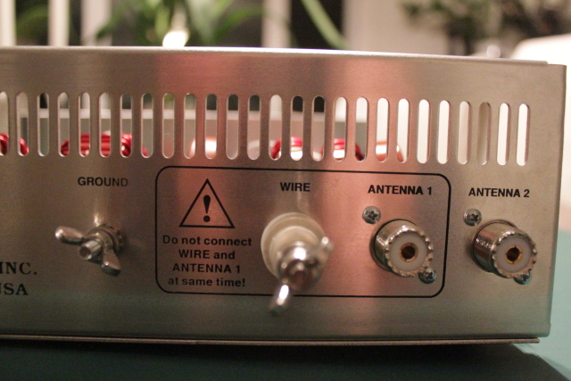

If you use balanced line, you would use an external balun and attach to one of the coax connections. The tuner does not have an internal balun to allow you to choose one that is suitable for your application.
If you use a long or random wire, you can use the terminal shown in this pic:
It's tuning impedance range is from 12 to 1600 ohms, which equates to a max SWR of 32:1.
