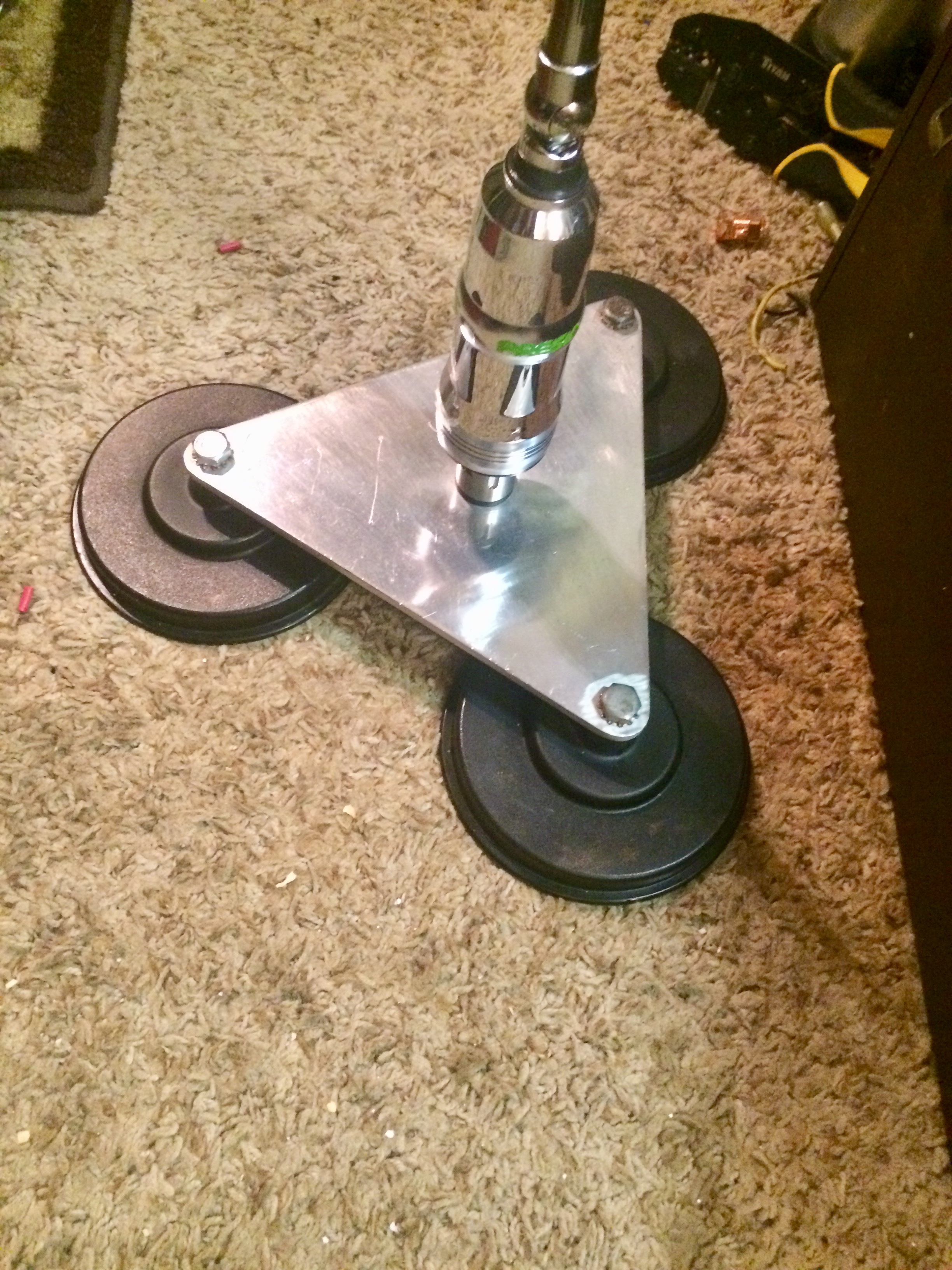

I have a 2017 Ram 1500 quad cab and today I began the process of removing the headliner to install a puck mount, upon disassembly I found there is NO space between the headliner and roof! Even coax will show a crease in headliner. I am now thinking about a triple magnet mount for my predator 10k and running 2 thick ground straps from it to the 2 screws on the 3rd brake light for ground. I am currently using a Wilson 1000 magnet mount...should I just stick with what I have or will I see an improvement? I do have the truck bonded with a total of 16 braided ground straps.

I had pretty good luck with my old Wilson 1000 mag mount but I noticed an improvement when I mounted my 102 on the trunk lid. I know it's not the same thing but I can only go with my experience. I never tried the triple mag mount so I'm not much help there. Over all I'd prefer a solid mount over mag.

The only support goes side to side and the liner is molded to its shape. I even thought of removing the dome light and just using the lens as a cover but it gives me a 3" x 5" opening which won't help. As for it being a new truck...yes the wife is not happy with the whole drilling holes in it thing...I'm also thinking about a roll / light bar as an option.
Don't really need to run ground straps off a Tri-Mag mount. Before turning my Suburbans roof into swiss cheese, I ran a Tri-Mag mount with my Predator 10K for several years...(no ground straps.)
Another option would be to mount a riser in the back, and stick the antenna on it...There's several hear that will tell you this either "won't work" or is not a good idea...Well, it may-not be the "Ideal" way to mount the antenna, but it works fine for me...I get out just as well locally with the antenna mounted on a riser, as I did with a mag mounted 10K on the roof. Plus even just running a little 2-pill I can still get my name called in DX.(when there use to be "DX")
