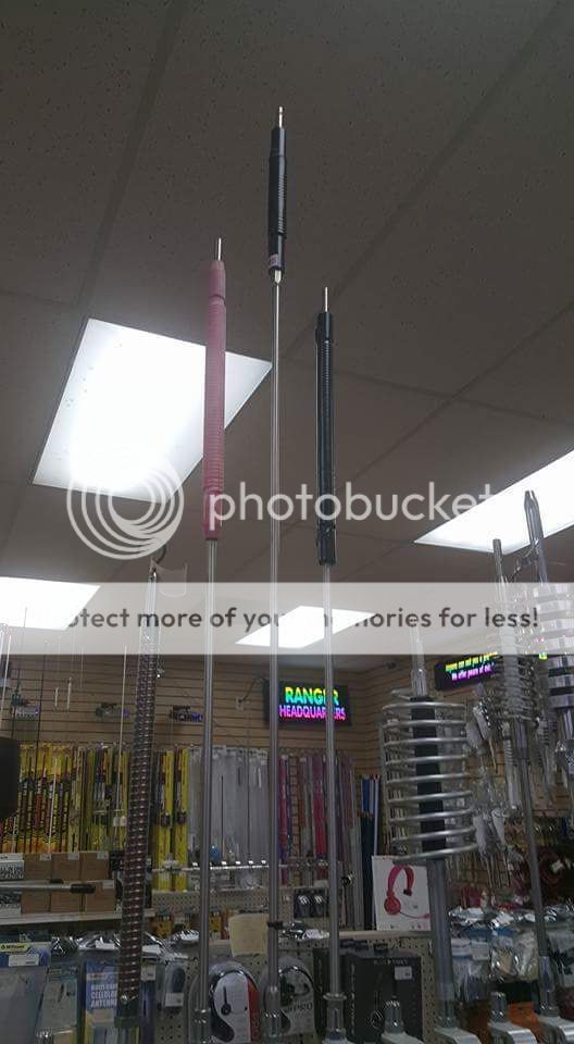

Here are replicas of the antennas I build for myself. Stainless where necessary and copper where strength doesn't matter encapsulated in shrink tubing.
Thanks for that. I was curious to see if you had a bare copper CB antenna, and if you did was curious as to its design. The shrink tubing will have a similar effect as the coating that forms on aluminum. Ever rub a balloon in your hair and have it stick to stuff? The shrink tubing is a similar material to that balloon. I would think the shrink tubing would be worse in this regard than the layer of aluminum oxide, but I am not sure and will need to do some research on that to know for sure.
You may look into a chemical passivation process for your copper antennas and compare such an antenna to your standard model. I know it can be done with relatively safe household chemicals. I would be curious if it actually made a difference in your case... Passivation happens naturally with aluminum, and is the cause of the aluminum oxide coating found on aluminum antennas. It is also the source of the chromium oxide coating that protects stainless steel.
