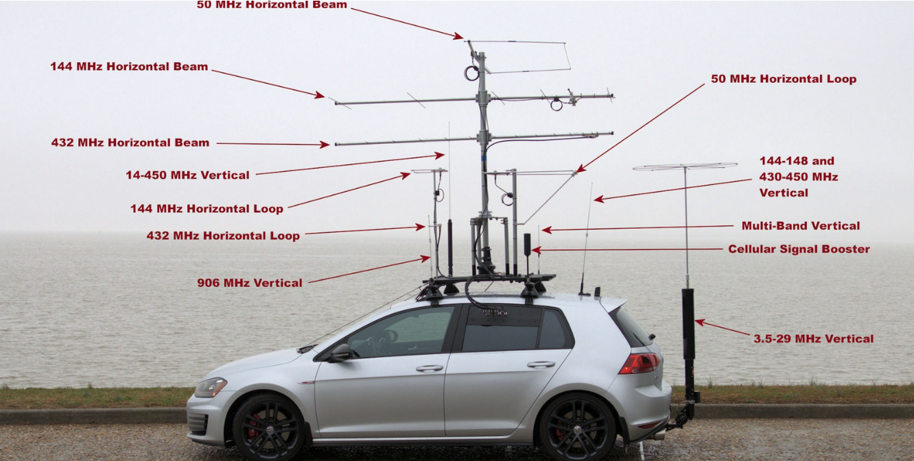

Vehicle owner here to address some common questions or comments: First, this is an exhibition setup. I remove the HF antennas when I'm in a VHF contest; I remove the Yagis when I'm not in a VHF contest. Here is photo of how the car looks most of the time...
Even this image is a tad behind since the car is constantly changing. As I was building and sharing photos with friends, one said, "You HAVE to take at least one ridiculous photo with everything mounted." I did; that's what inspired me to share the exhibition setup at shows. The car was a hit at HamCation last year! It was my first hamvention of any sort in over 20 years. I get decent questions at car shows; but most car nuts don't quite understand what they're seeing or what to ask. HamCation blew me away with awesome interaction.

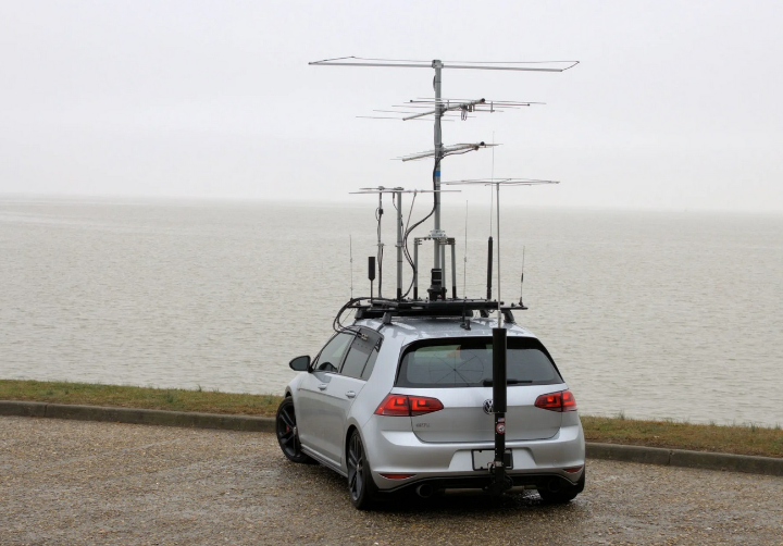

The photo at the top with the Rohn tower section was an "improvement" that was recommended by an engineer acquaintance. She felt that my original "micro-tower," shown in the second photo, lacked structure. While the Rohn piece certainly has structure and is strong, it's simply too tall for my likes. I experimented with the Rohn tower on a trailer during the VHF contest weekend...
It worked and was functional. However, the trailer is VERY difficult to back in the dark. I simply cannot see it or where its wheels are going. Backing is important for a contest rover because of our "grid circling" techniques. Being able to turn around quickly to get across a grid line is beneficial as we pursue points multipliers for working stations from a new grid. So, the trailer saw one contest and will soon see the tower's removal.
I will return to a setup that's very similar to the first photo, but without "all of the antennas," except for exhibitions. ;-) In fact, here's a photo from last June's VHF contest... no loops...
The new setup will look very similar to this, but I will cut about 18 inches from the mast to bring the setup down to 10'2", or about 3m. With the 432 MHz Yagi below 40 inches, I may need to relocate the taller verticals and travel without the loops, the 6m loop for sure. I'm using a smaller caphat on my Scorpion these days; so, perhaps it won't be affected by the 432. We'll see when I get it done. Stop by and see me at HamCation to see how it turned out.
Some answers to common questions or comments: The car is street legal. In the US, most roads must allow for a height of 13'6", or 4.1 meters. Any bridge or tunnel that's shorter is clearly marked, often well in advance to give trucks enough warning to find another way around. The thing that gives me the most trouble is TREES. Most highways have plenty of clearance, but those pesky landscaping trees in cities are problematic. They're cute when they're first planted, but grow into the lanes over time. I catch my 6m Moxon at the sides far more often than anything touches from the top. I completely understand why trucks and RVs travel in the center lane when landscaping trees are present.
