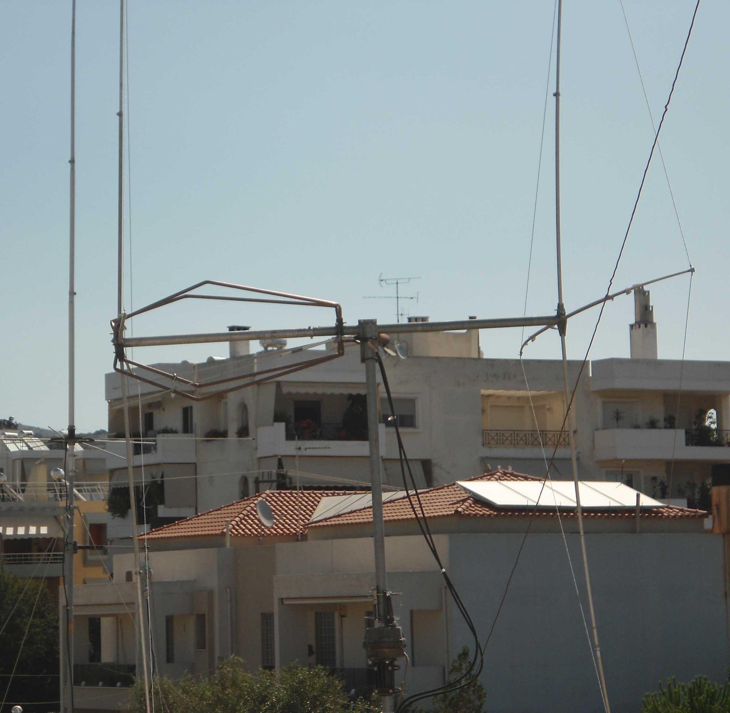

Hi Brett,
Hopefully, you can see the bent copper pipe matching section. Its a bit crudely done but should be OK. I had to increase the boom length because the matching section took a bit more real estate than the original 'globe' did. The original boom length was 58" and now its 73" long.
Yep, agree on your comments about performance and stuff. I've decided to concentrate on 20m and up from now on because I can't get any real height above ground for the low bands. I'm hoping I can use this type of design for 20m & 17m.

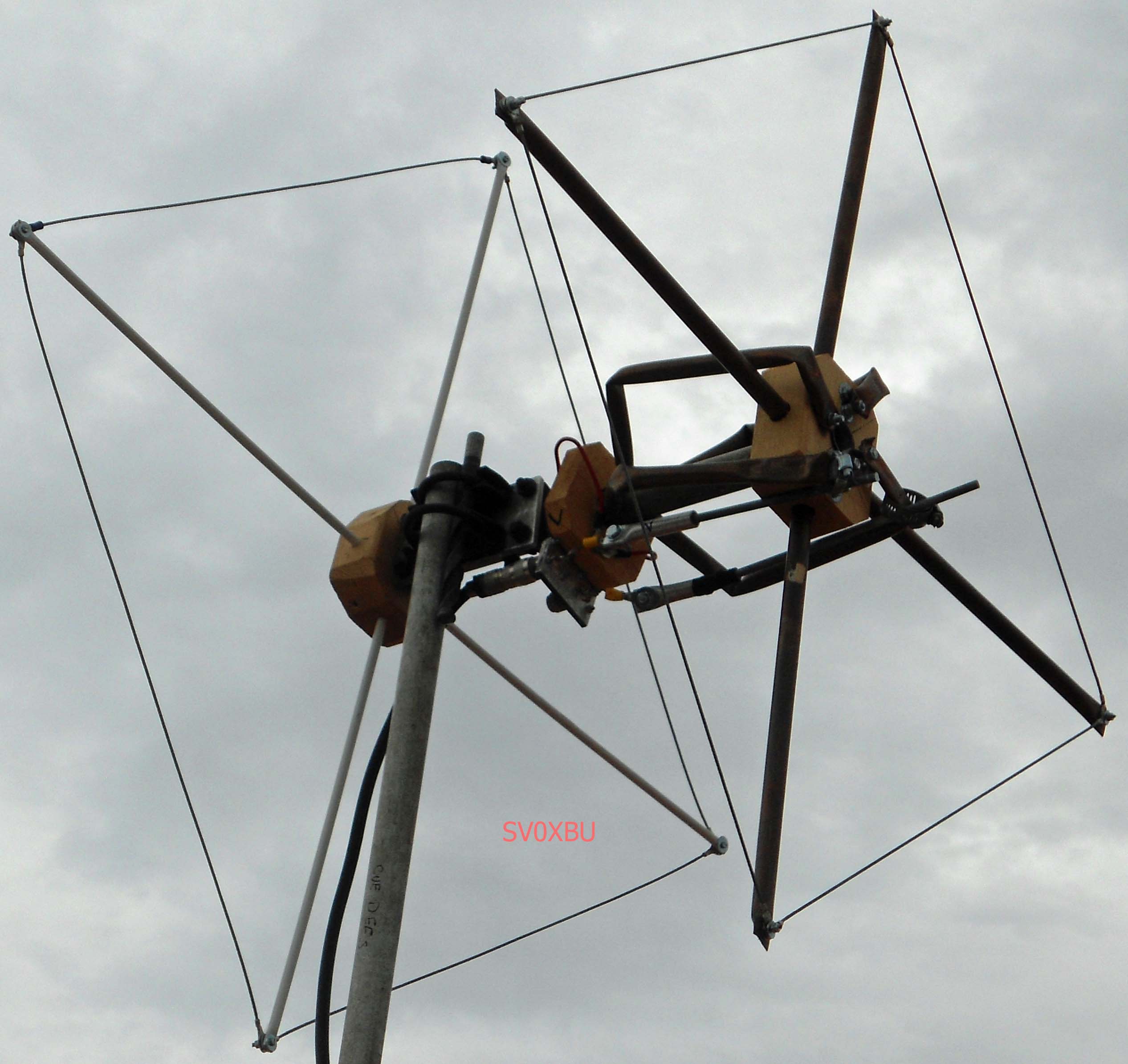

I'm no Charles Ingell when working with wood and metal but thought I'd give this a go because it turned out so simple in the end.
It's almost impossible to find hubs for the PDLII so I used a block of wood for all 3 hubs. The image below is for a PDLII for 2m and if only I could believe EZNEC's performance data i.e. F/B at 48 dB, gain at 12.5 dB and a TOA of 15 degrees!! The average gain test was 1.08 and fairly confident it will work well but I am cautious on the modelled data.
I've been lcensed since 1985 and 2m SSB has always been my favourite band. I rarely use 2m now because its a real challenge getting out a signal due to all the mountains around where I live. Initial checks against a local beacon and numerous repeaters show its working as well as my previous long boom 10 ele crossed yagi from M2 - and that was a beast of an antenna.
If like me, you love how these antennas operate, a hard block of wood might be the answer to your next project.
I will attach the EZNEC model later plus info on how to tune it can either be found in the antenna Notes of the model or txt file for the non-modellers.​
