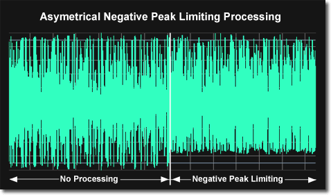

I sent Dave a note and asked him if he would show how a NPC/RC mod should look on a scope. I know that a scope cannot detect the asymmetry of the form; just what the scope reading should look like in general. As well as discuss other pros and cons of using a scope. We will see what happens.

Sure a 'scope can detect and display the asymmetrical waveform. Why couldn't it? In broadcasting we routinely ran 100% neg mod with 120% pos mod. and set the levels with a 'scope. One time I had problems with a solidstate TX that was pulse code modulated (PCM) class D. It had adjustments to set the pos mod peaks. During testing we ran it at 100% neg and a bit over 200% pos peak mod to see if it would break down. The 'scope displayed the waveform beautifully.

Pretty much was my thought too. Just wondering how to do it right using a scope though. I can use a scope for a bunch of things; but reading asymmetric modulation is not one of them. Want to nail that one next, as I have a radio or three that I want to use the NPC mod on and do it RIGHT . . .
I don't know what you are looking for Robb. Looking at asymmetrical mod is the same as symmetrical mod except the pos peaks are higher than the neg peaks. Set the scope up to show a carrier centered in the display.Adjust the vertical deflection control to say four full divisions that way each little reticule is 10% modulation.The neg peaks should extend no more than two full divisions below the carrier and the pos can extend to whatever you want. Modulation can be read by how far above the carrier the peaks extend.Below is an image showing normal symmetrical audio and asymmetrical audio. See the difference on the right? This is not a great pix but it shows how the pos peaks extend further than the neg peaks.

As far as being able to see asymmetric modulation on a scope, yeah, you should be able to do it, but I think you sort of need to sit and carefully count the divisions in the reticle in order to gauge it. With a symmetrical sine wave, you know the crossover point is right between the peaks, but once you start compressing the negative peaks, it can be a little hard to just eyeball it. I think the best way to do it is to start with a dead/unmodulated carrier and set the transmitter power and/or scope signal attenuator controls so that it fits exactly between to major divisions on the screen. Those division lines are the crossover points for the audio waveform that you'll be superimposing onto the carrier. Once you've made a note of those reference points, you can start cranking up the mic gain until you reach 100% modulation (the positive peaks should now be two major divisions wide instead of one). Then as you keep turning the gain up, the positive peaks should keep growing and ideally the negative peaks should remain at their current positions and retain their curved shape, but start to look more "smushed" compared to the positive peaks.
There's one thing I've never been to clear on about this though: some NPC mods prevent the negative peaks from reach 0 output entirely (i.e. from letting the waveform on the scope turn into a flat line), but still allow the negative peaks to attain a flattened shape. But supposedly it's that flat shape that causes most of the unwanted harmonics to be generated (the closer you get to a square wave, the more harmonics you get), so I would think it would be better to compress the negative peaks while preserving the sinusoidal shape too. But people don't seem to worry about maintaining the curved shape though, and I'm not sure why.
My guess is that it's probably preferable to use the latter approach, but it's technically easier to accomplish the latter, and while allowing the negative peaks to flatten out is not as good as keeping them curved, it's considered a reasonable trade-off.
