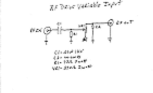

Idea if you want to consider modifying that old Mohawk. With such a small amount of RF producing that much of a carrier, maybe put a variable input resistor, sort of like Texas star did there amplifiers.
That way the op can control the dead key with the variable instead of trying to tune the radio to match the amp.

rf drive variable input
wavrider, think this would work? could be made in external box for shack tool or made for amp without mod to amp. soretooth
