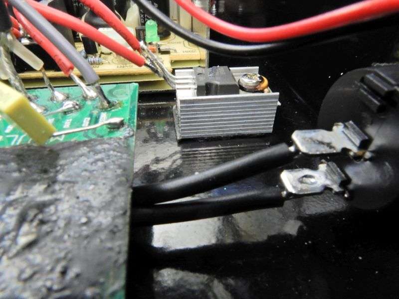

Most common way to do this is buy a chinese switchmode DC-power "brick" to provide the 24 Volts (yes) DC that runs this show. A modulation transistor and heat sink that are big enough are a really good idea.

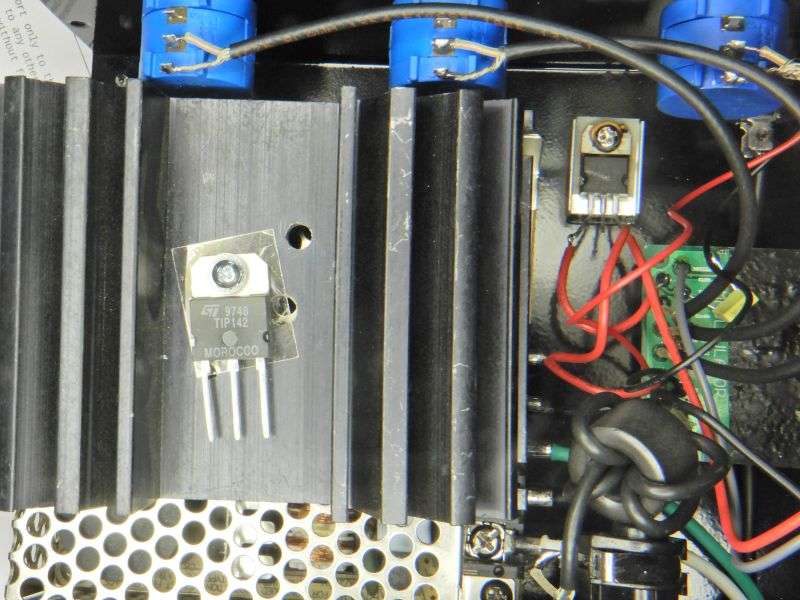

Shouldn't take an expert to see this heat sink is probably not big enough. The melted plastic shoulder washer on the transistor is a clue.

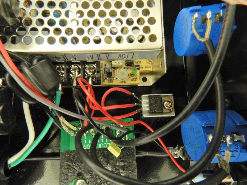

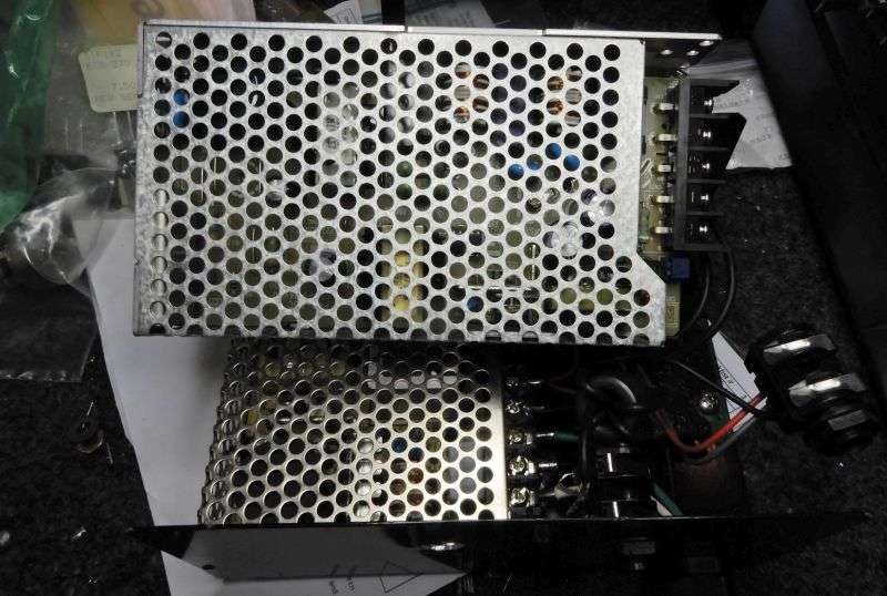

This power supply is in theory the right size. I would prefer one a bit larger, but those won't fit inside this cabinet.
I'll cross my fingers and assume the other "kaboom" issues caused this supply to fail. Gotta keep in mind the bigger the power supply, the bigger all the stuff downstream from it has to be, or risk breakdowns. We'll install a new one that says "MeanWell". That's the traditional quality brand, if it's not counterfeit.

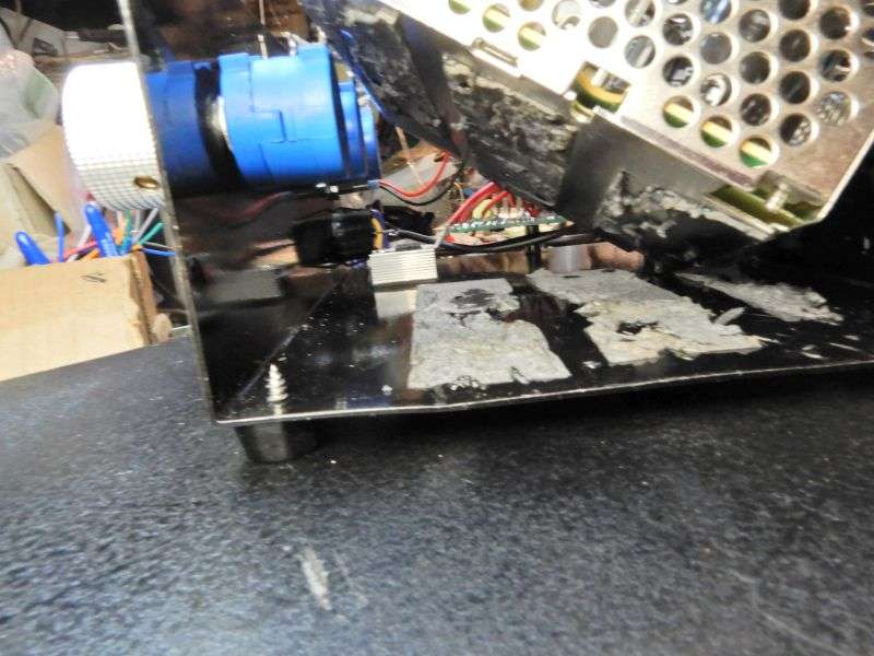

Using double-sided adhesive foam saves assembly time. Has the opposite effect if you ever want to take it back out. We'll be scraping this stuff off and using threaded hardware to secure the power supply.

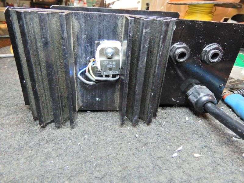

The modulation transistor and heat sink both get upgraded.
This heat sink just fits on the rear of this cabinet.
