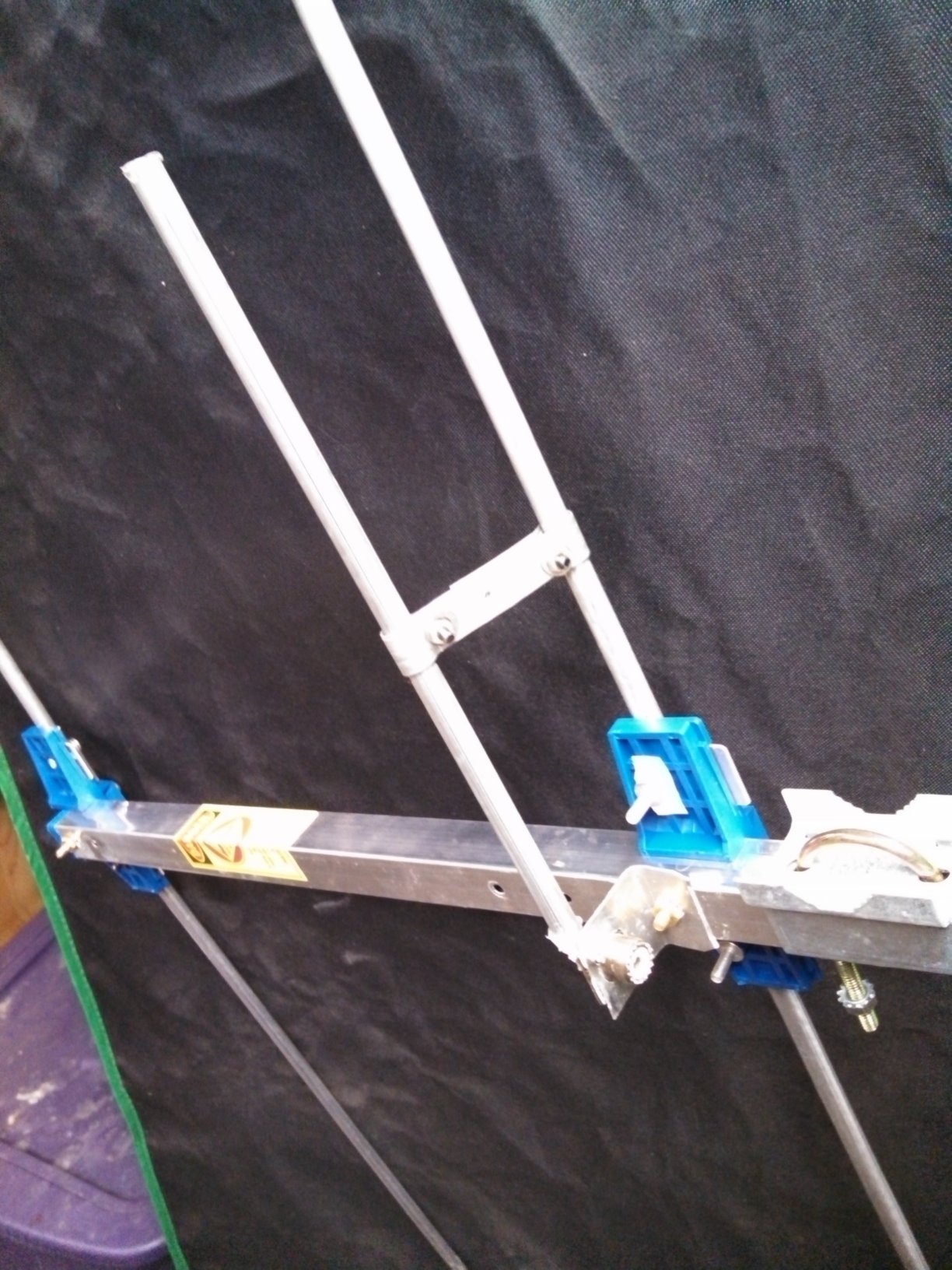

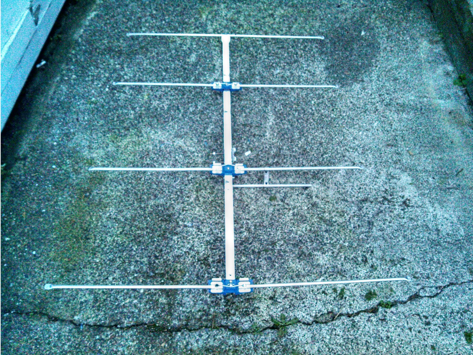

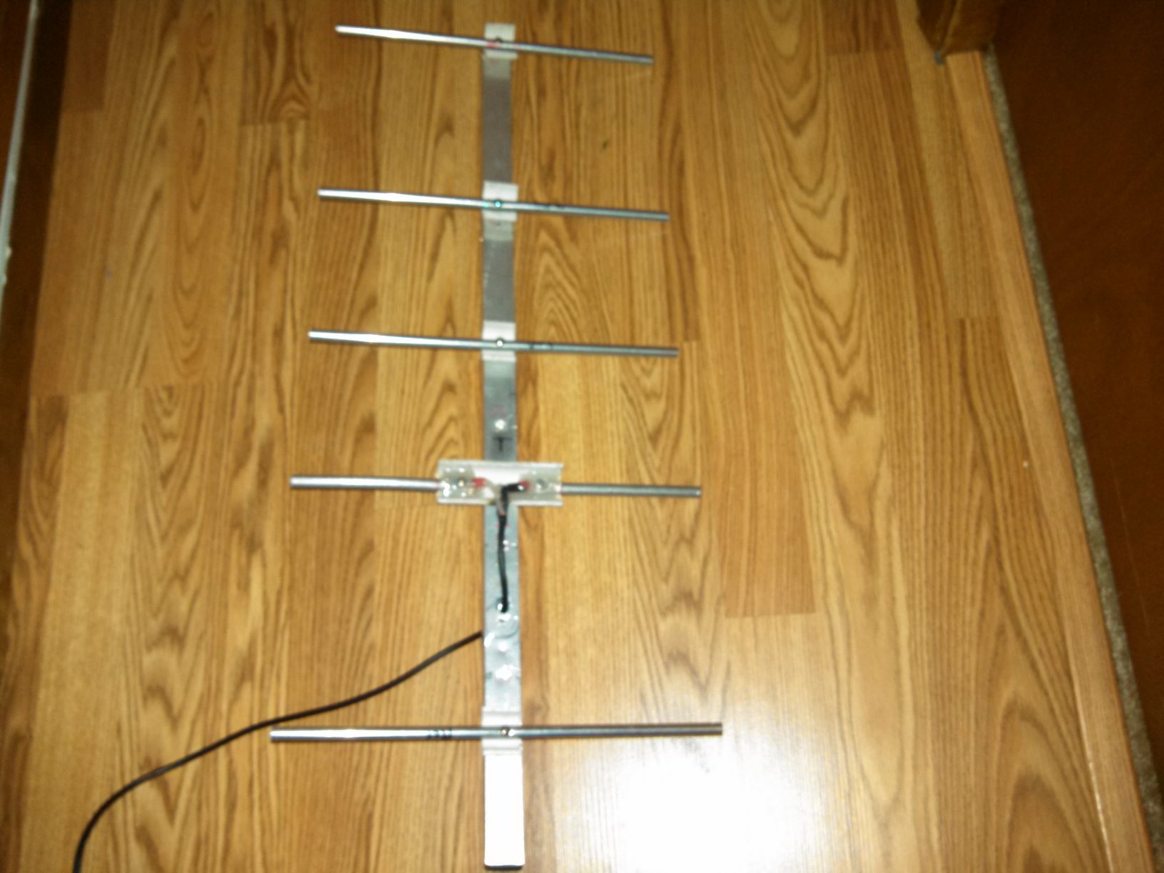

I passed my tech test the other day but I've been working on my rig and such so I'm ready when I get a call sign. I got the designs for all off of the good ole internet (it has to be true right? LOL). Had to do some serious tweaking to the 2 meter to get it to resonate where I wanted. The 70 cm one is just picky. Swr is low at 420, high at 425 then low from 430-440, then high at 445 and low again at 450! I don't get it. I have an MFJ 259B but can't use it for vhf. Oh well we will see how it behaves when it's 30' in the air. I also built a 2 meter slim jim from copper pipe that receives great and a G5rv for 10 meters. I'm already having fun and haven't even transmitted yet.
