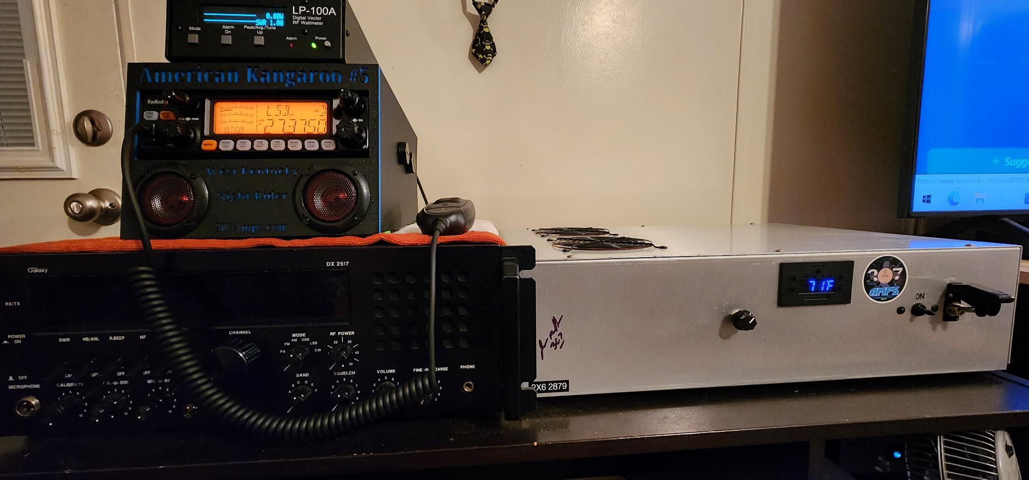

My Humble 11 Meter Station
What's the story on that Galaxy DX- 2517 ? Will that talk ?

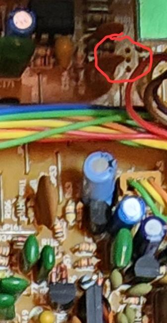

Yeah, it came back around, but I took the cover off, and discovered a missing 2SC945. My RF power doesn't do much in the way of reducing RF power, and I suspect the missing transistor might have something to do with it.

No one in here really knows you and how you operate or what you have done or not. We are just looking to try to help you. Have you taken that Galaxy 2517 out of the circuit also and still have the problem ?
Common sense dictates that one would begin the troubleshooting process, by taking everything out of line, and testing the radio itself, which I did.
In the beginning, I thought the amplifier was the problem, but it was just protesting, due to CMC getting into my equipment, which I have resolved by replacing the antenna and moving my equipment farther away from it, as my equipment used to be directly under it more or less, and the base of said antenna, being only 25 feet above ground level.

If the radio is sounding crunchy on ssb, my first guess is that the output bias is set incorrectly. The best way to listen to your transmit audio is with a second radio with headphones and no antenna. This is a great way to adjust the mic level too. The first thing to try would be to reduce the mic level and see if it helps. If not, and it is on USB and LSB then I would say that the bias is wrong.
