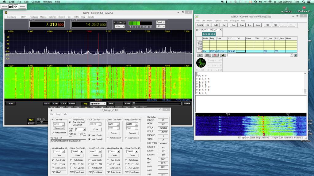

Some of you saw my post a while back about how I got the NaP3 panadapter windows application running on my Mac using Parallels. I've also been successfully running MixW and a few other Windows ham radio apps. Well, over the last few days, I decided to take it a step further to see if I could get LP_Bridge working so I could use one serial port to access and control the Elecraft K3 at the same time. I was surprised how easy it was to configure and get working! Here's a screen shot of my Mac running both NaP3 and Mix3 with full sound card interface and rig control from both apps:

Hi I'm interested in doing this as well. I have an iMac 21" Late 2013 but do I need a mic/line in? This model does not have one I believe.
I want to connect to a Yaesu FTDX3000 via the IF port.
Thanks for your help.
Yes, you need a sound card with stereo line or mic in. Ideally it should have 192khz bandwidth so you can see the widest bandwidth possible. The built-in soundcard for most PC's (including the iMac) won't cut it so you'll need to add an external USB one. Asus, Diamond, Creative Labs all make suitable ones for under $100.
