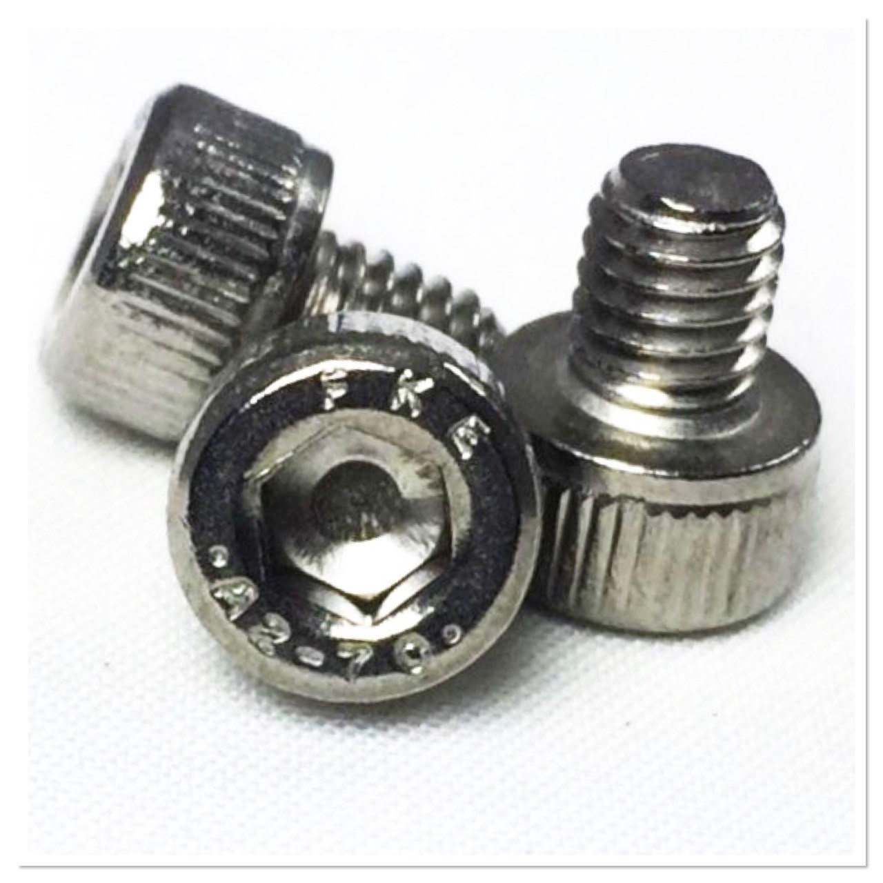

so today i receive my sirio GP-27 1/2 it's altogether and up on a 15ft mast 4 watts from the radio 1.1 swr
so i bring the antenna back down for one final check on the screw that holds the top stinger every time i tighten it seems to loosen up when up in the air, it is a M4x4 hex screw i was thinking off switching it with a M4X6 with a tad deeper head for better grip been the original one it's already stripping on the alen head side

My Sirio Vector 4000 has the same thing. I stripped the hex out of it when I tightened it. Then I tried to drill it out but couldn't. So I put it up anyway. Then a big bird bent it on about a 40 degree angle. Then I noticed the wind would swing it around like a weather vane. Haha!
So I brought it down and got a stainless bolt that sticks about half inch out the side. Tightened it up and haven't had a problem. The grub screw is for it to look pretty, but it is over 50 feet to the tip and nobody can see it anyway.
i was looking at this type if all fails i can still grab it with pliers these are stainless steel

Common sirio issue. M4X6 and loctite blue with 24 hour cure time and hike it back in the air.
Always works for me!
The rocking motion it the wind causes the set screw to back out. 1st time it happened to me in one week the stinger droped all the way in. Brought the antenna down and set screw was gone. A longer set screw (4x6) and blue loctite prevents the issue. One and done!

Red loctite means your never taking the set screw out ever again. Blue means you can take it out in the future to adjust swr, etc.

PS. If you do use red loctite, a little heat from a propane torch will set it free.

thanks, i'll try the blue stuff first the antenna is not hard to take down i'm still waiting for approval from HOA but i snuck it up there to test it out 1.1 SWR waiting on my 2 pill
