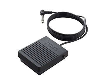

Here's Another idea for a PTT switch that I once used.
You can buy a cheap piano keyboard sustain pedal. These are momentary non latching switches and the small square ones work well on your desktop with little effort and also works as a footswitch. These can be bought at your local music store or online for about $15.
Here's one example by Korg, model PS-3
Yamaha FC-5
